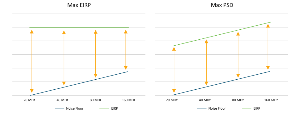

Power Spectral Density You Say?
The 6 GHz rules bring another interesting twist. In 5 GHz and 2.4 GHz, the transmission rules are driven by the notion of maximum Effective Isotropic Radiated Power (EIRP), which is the maximum quantity of energy emitted by a client or an AP. As the max EIRP is fixed, a system that transmits over a 20-MHz channel transmits more energy per unit of frequency (per MHz) than a system that radiates the same total amount of energy, but over a wider channel, for example, 80 MHz.
The idea is the same as a water hose. If your hose delivers 1 liter per second, it will spray less water per unit of surface if you spread the jet as a flat 3-meter-wide mist than if you focus the water, power washer style, over just a half square centimeter target. A direct, and sometimes hidden consequence of this rule is that if you set your AP channel to a width of 80 MHz (instead of 20 MHz), your cell size is mechanically reduced because the amount of signal available over each MHz of the channel at a given distance is now lower. A common way to express this reduction is to say that the signal-to-noise ratio (SNR), over each MHz of frequency, reduces as the channel width increases.
The Wi-Fi community expressed this concern when the 6 GHz allocation was being discussed by worldwide regulatory bodies. The great news is that the community was heard, and the rules are different for 6 GHz band. In this new band, the max power is no longer a ‘total max’ EIRP but is defined as max Power Spectral Density (PSD) or the max power per MHz—in the hose analogy, that’s the water delivered per unit of surface. This limit is per MHz and does not change as the channel width changes. In practice, this means that a 6 GHz system can send the same amount of energy per MHz in an 80 MHz channel as it would in a 20 MHz channel, and therefore that the cell size stays the same, regardless of the channel width. It just sends more total energy as the channel size increases.
