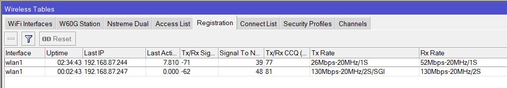

Looking at the registration is a great way to diagnose indeed. The signal strength in the registration table for a client is the strength of the client signal !!!
LOW antenna gain , like in most low end hAP, cAP and wAP, does not amplify the client signal like an AP with high antenna gain
Both client devices at same location (living room)
First line , smartphone Xiaomi Mi 3 , -71 dBm
Second line , laptop Acer , -62 dBm
Acceptable CCQ , good interface rate (smartphone is sleepy!).

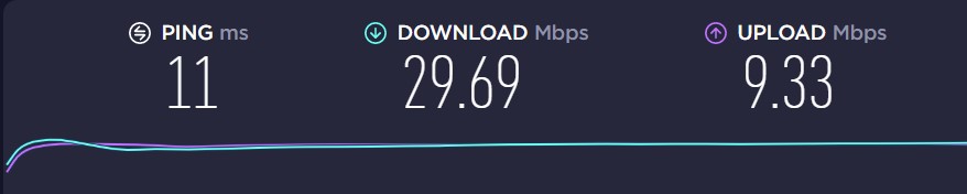

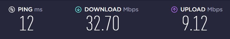

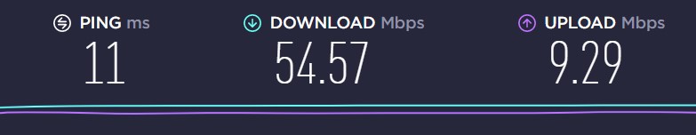

Laptop Speed test (ISP VDSL2 bandwidth wired is around 55/10Mbps, I pay for 100Mbps but it’s a long VDSL line)
hAP Lite works great even at -86dBm
Compared to ISP modem (same location as hAP Lite in the garage)
hAP ac2 in the living room gets full 55/10 Mbps on 5 GHz

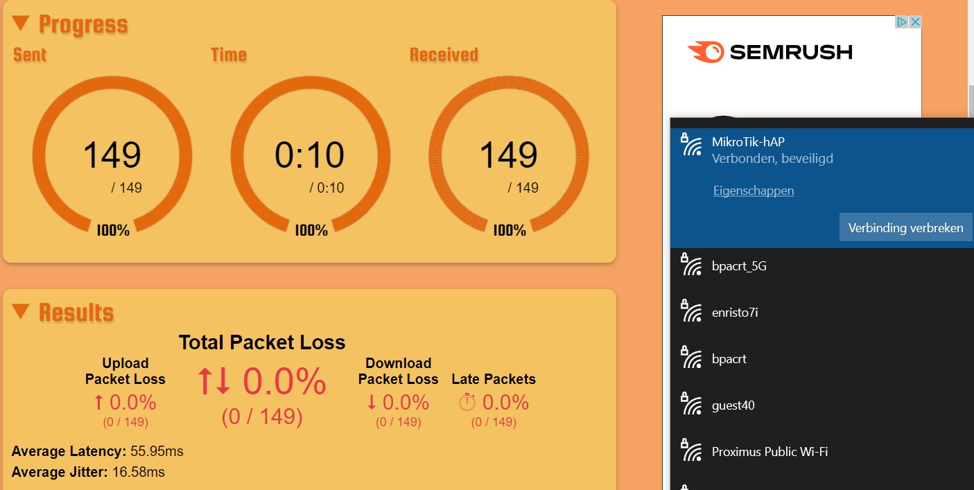

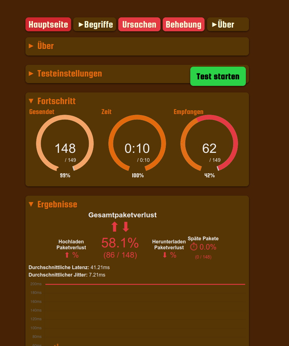

Try that packetloss site. E.g. when using low-latency audio the performance is not acceptable. At least in my case and that of the OP.
Nice test site. I used Germany.
No problems detected.

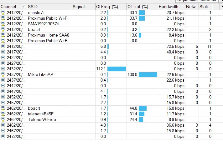

Let’s verify why the hAP Lite did not go to full speed. CCQ of 81% is a first reduction of the throughput.

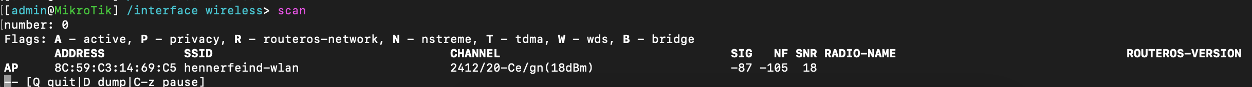

Scan shows a rather free channel 6 (2437) on yet another MT (wAP ac , 2 wall’s separated from living and garage, but this is OK to “listen”)
Neighbors are also active in channel 1 and 11
So this is OK ! or not ? Well the higher noise floor on channel 6 is an indication of some RF activity.

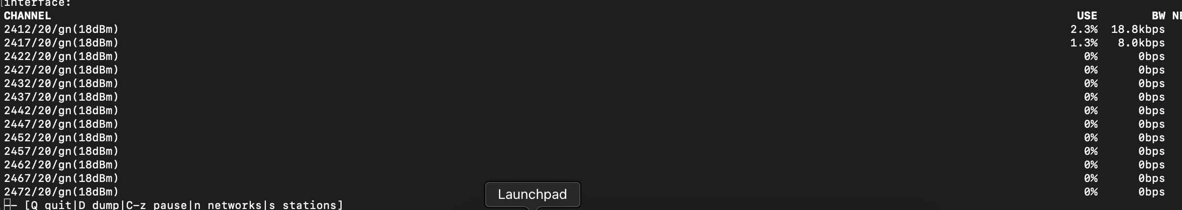

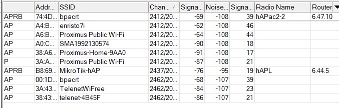

“Snooper” shows more …

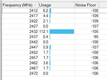

Not so clean anymore (1-6-11). But the most important disturbance is the channel 5 (2432). That’s a lot of activity there, and no recognised network or stations.
I don’t know where this comes from. Is this non-802.11 ?? If NV2 it would be recognised by MT. This will rise the noise floor for 2437 ?? It will be destructive adjacent channel interference.
The channel 5 usage is confirmed with “Freq usage..”

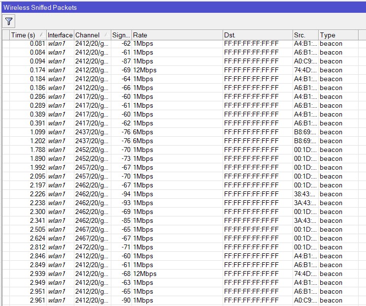

“Sniff.” shows no beacon or other packets for 2432 at all. And wow the ISP and neighbors devices send a lot of 1Mbps beacons. (this consumes 3% airtime per SSID, but on non overlapping channels, so no problem for the hAP Lite)

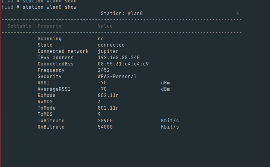

Connection stats on my client:
