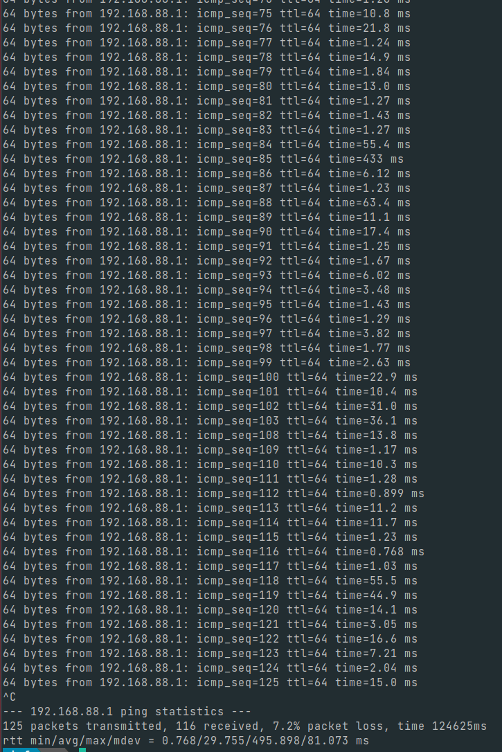

Pings tend to be flaky too:
Usually low pings around 1-2ms. Then it suddenly increases at seq 100 and leads to a loss of 104-107.
Infabo: that is whay I mean and what I encounter as well, you need to set a longer testing time in that app to always catch it.

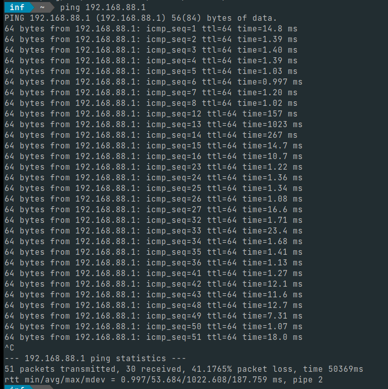

Uff, that didnt take long to find out - does not help anything.
 inf  ~  ping 192.168.88.1
PING 192.168.88.1 (192.168.88.1) 56(84) bytes of data.
64 bytes from 192.168.88.1: icmp_seq=1 ttl=64 time=16.3 ms
64 bytes from 192.168.88.1: icmp_seq=2 ttl=64 time=39.2 ms
64 bytes from 192.168.88.1: icmp_seq=3 ttl=64 time=1.21 ms
64 bytes from 192.168.88.1: icmp_seq=4 ttl=64 time=14.0 ms
64 bytes from 192.168.88.1: icmp_seq=5 ttl=64 time=1.20 ms
64 bytes from 192.168.88.1: icmp_seq=6 ttl=64 time=3.91 ms
64 bytes from 192.168.88.1: icmp_seq=7 ttl=64 time=1.20 ms
64 bytes from 192.168.88.1: icmp_seq=8 ttl=64 time=13.1 ms
64 bytes from 192.168.88.1: icmp_seq=9 ttl=64 time=1.23 ms
64 bytes from 192.168.88.1: icmp_seq=14 ttl=64 time=267 ms
64 bytes from 192.168.88.1: icmp_seq=15 ttl=64 time=85.2 ms
64 bytes from 192.168.88.1: icmp_seq=16 ttl=64 time=48.6 ms
64 bytes from 192.168.88.1: icmp_seq=23 ttl=64 time=22.1 ms
64 bytes from 192.168.88.1: icmp_seq=24 ttl=64 time=84.0 ms
64 bytes from 192.168.88.1: icmp_seq=25 ttl=64 time=1.99 ms
64 bytes from 192.168.88.1: icmp_seq=26 ttl=64 time=1.81 ms
64 bytes from 192.168.88.1: icmp_seq=27 ttl=64 time=21.1 ms
64 bytes from 192.168.88.1: icmp_seq=28 ttl=64 time=26.6 ms
64 bytes from 192.168.88.1: icmp_seq=29 ttl=64 time=1.29 ms
64 bytes from 192.168.88.1: icmp_seq=30 ttl=64 time=1.27 ms
64 bytes from 192.168.88.1: icmp_seq=31 ttl=64 time=15.1 ms
64 bytes from 192.168.88.1: icmp_seq=32 ttl=64 time=1.26 ms
64 bytes from 192.168.88.1: icmp_seq=33 ttl=64 time=1.19 ms
64 bytes from 192.168.88.1: icmp_seq=34 ttl=64 time=53.2 ms
64 bytes from 192.168.88.1: icmp_seq=35 ttl=64 time=1.31 ms
64 bytes from 192.168.88.1: icmp_seq=36 ttl=64 time=74.3 ms
64 bytes from 192.168.88.1: icmp_seq=37 ttl=64 time=18.9 ms
^C
--- 192.168.88.1 ping statistics ---
37 packets transmitted, 27 received, 27.027% packet loss, time 36166ms
rtt min/avg/max/mdev = 1.194/30.272/266.800/53.018 ms

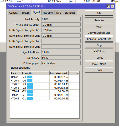

While I am pinging and seing the losses, all other clients seem to be idling.
[admin@MikroTik] /interface wireless> registration-table print interval=1
 # INTERFACE                             RADIO-NAME       MAC-ADDRESS       AP  SIGNAL-STRENGTH TX-RATE UPTIME
 0 wlan1                                                  A8:7E:EA:55:9F:10 no  -71dBm@HT20-5   24Mbps  8m19s
 1 wlan1                                 2CC81B432764     2C:C8:1B:43:27:64 no  -86dBm@1Mbps    26Mb... 8m18s
 2 wlan1                                                  FC:49:2D:10:BE:1A no  -72dBm@1Mbps    72.2... 8m17s
 3 wlan1                                                  68:A4:0E:23:A9:69 no  -70dBm@1Mbps    5.5Mbps 8m16s
 4 wlan1                                                  76:6E:4F:6A:81:57 no  -73dBm@1Mbps    26Mb... 8m2s
 5 wlan1                                                  B8:C3:85:AA:5E:2E no  -56dBm@1Mbps    11Mbps  5m45s
I assume, the hap is taking a deep breath. Because of all the work he has to get done. Limited hardware.

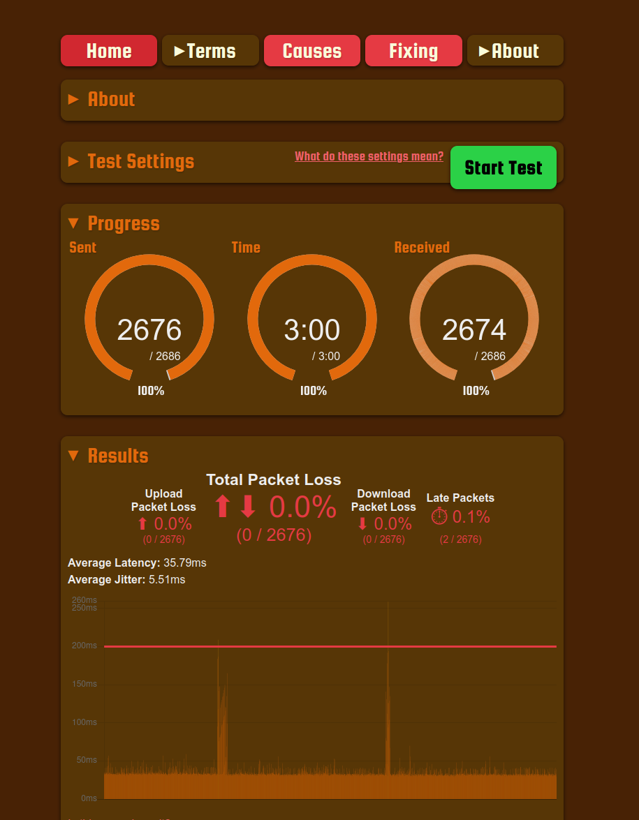

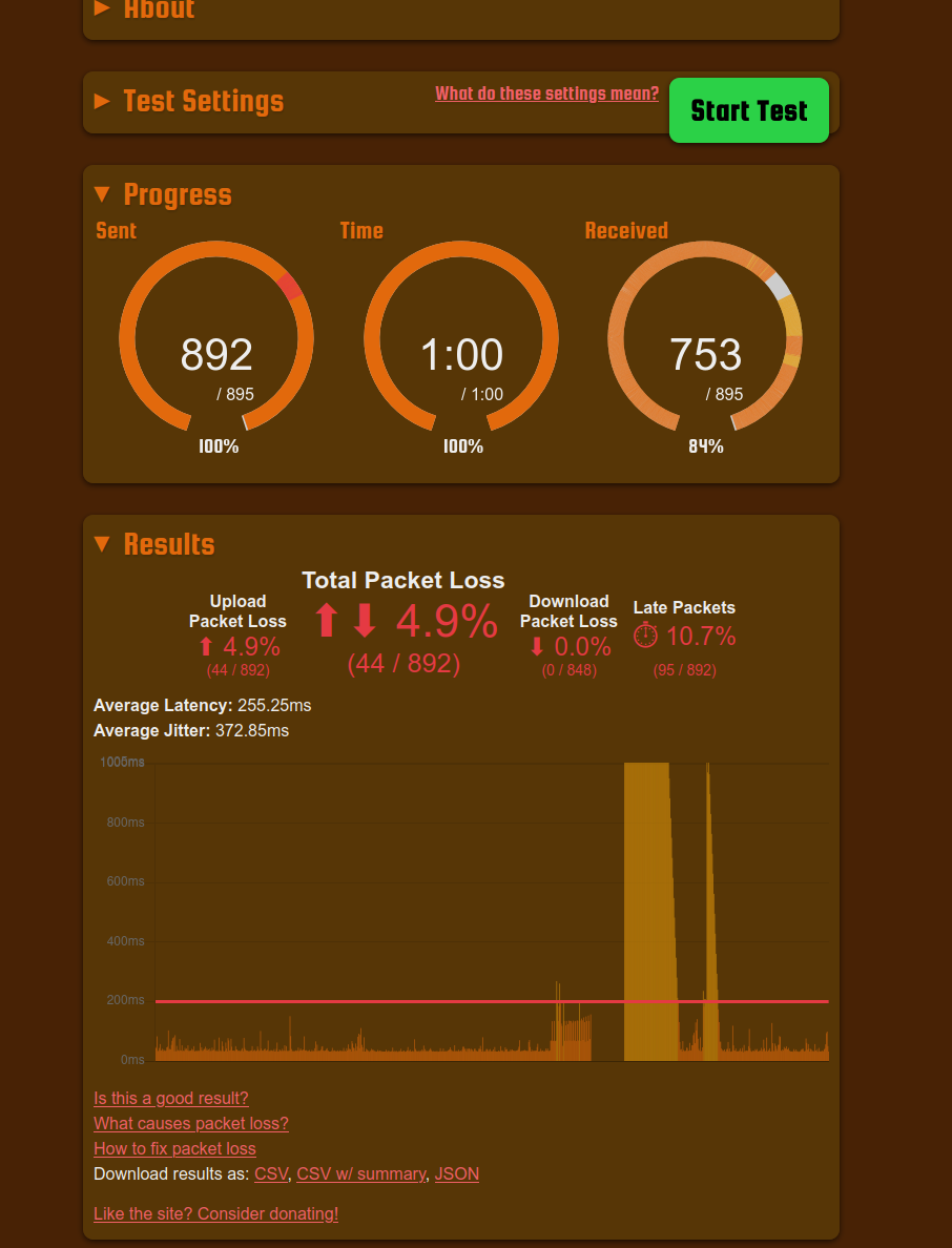

That is the kind of pattern I saw as well. Not a problem when just browsing, but very irritating when doing audio chat and conferencing.
As my hAP mini was a freebie from the MUM and I did not want to spend too much time on this, I just ordered a hAP ac2 and it was fixed.
Of course I am now on 5 GHz but I think it works OK on 2 GHz as well, will try to test that later.

In my humble eyes this is a quite OK signal. It has a a good SNR and OK signal strength as well. So why do I see all these issues then?

Despite all adjustments, packet loss is still unchanged.
