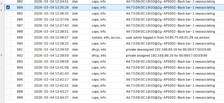

I upgraded the devices at a client site last week to v7.2.3. They have two old hAP lite devices configured as switch/access points (not router). Had a bit of trouble getting them upgraded via CAPsMAN due to lack of memory but sorted that. Both of them are working (i.e. client devices are connected via Wi-Fi) but one shows continual reassociating in the log - often several times a minute. Any ideas and what exactly is “reassociating”?
I’ve tried a reset configuration into CAPs mode - no difference. Very strange!

This says “The reason why Station reassociates must be looked for on Station” - there is nothing in the logs on the station - probably ‘cos CAPsMAN managed? Need to enable some debugging events maybe?
