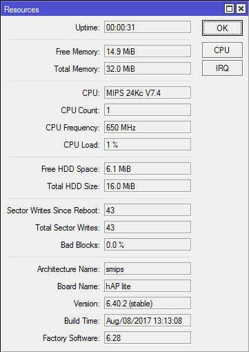

A hAP lite classic (ROS v. 6.40.2 stable) was brought to me with ‘not updating problem’.
Where’s actually no space on flash to upload firmware as expected. But there is no ‘/flash’ directory on the /disk and all files seems are on flash (if there is any). And no gain through Internet upgrade also.

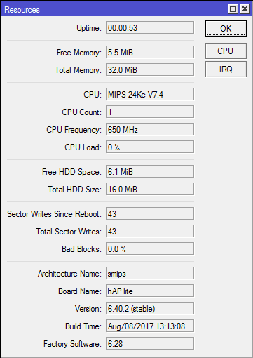

Also there is no free RAM for firmware. About 10MB of free RAM disappear several seconds after reboot:
