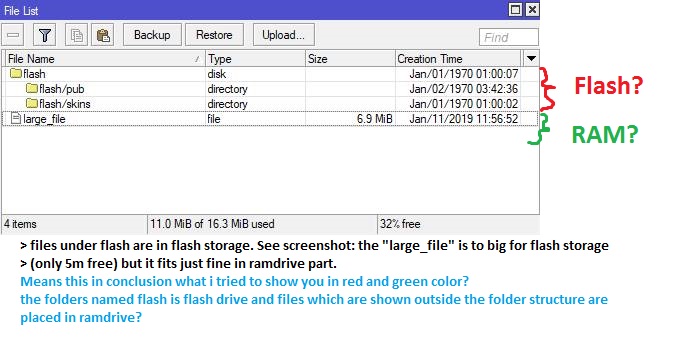

don’t use the flash dir or subdirs. these are on limited flash, rest is in memory and you’ll be able to write more but limited to your available mem.
Edit: see the attachment in additional post below

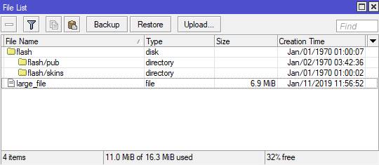

Under the Winbox tool, go to the “Files” menu option. Clear out anything there you’re not using.
Are all the files i see in root dir only in ram drive? Because i saw an npk file there
files under flash are in flash storage. See screenshot: the “large_file” is to big for flash sotrage (only 5m free) but it fits just fine in ramdrive part.
Thank you, and how I access the ramdrive? May i delete all the folders and files shown in your Screenshot . I mean the ones in my files folder. To get more space free.
For standard home use you can remove safely all files and folders from File List
(flash folder cannot be removed but all sub folders yes)

Files not within “flash” path are indeed in ramdrive.
so then i think: the npk file i see last time, was in ramdrive. i will see in two hours.
After deleting the folders i saw in Mikrotik-App (on android device) i still got several times the message, shown in attached image.
But finally it worked after several tries and restarts.
