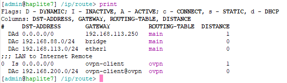

and it inactive?

The default route in the ovpn table is shown as inactive and won't work. Did you by chance put ovpn-client in a VRF (named ovpn)? If yes, the static route you added has to specify the gateway as ovpn-client@ovpn, not just ovpn-client.

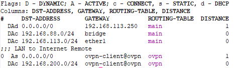

I added "ovpn-client@ovpn" as the gateway:
I added the action "lookup-only-in-table."
but the problem persists. I always exit the local provider and not the ovpn tunnel.
Yes, it was inactive because I hadn't set the correct gateway "ovpn-client@ovpn" as reported by @CGGXANNX.

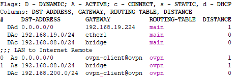

You're absolutely right. I removed min-prefix=0:
And added the route for the local network with the routing table "ovpn":
Now the remote client with IP 192.168.88.x browses with the public IP of the central router connected to Ovpn.
