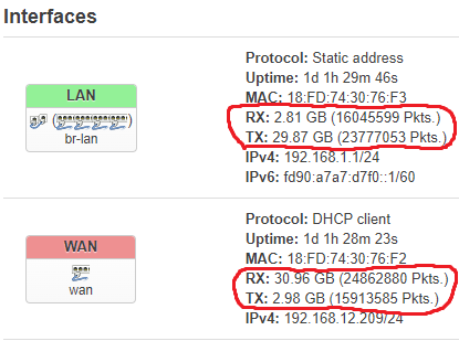

I think I’m just dum-dum and was imagining that weird speed-padding. Found this nice tool (netdata) to monitor CPU/network usage in realtime and found that it most of the times reaches its set limit or just under when under heavy load from multiple devices. One interesting thing I found though, was that it does seem like there’s some lost packets going between the internet and my LAN as seen in this attachment:
I can’t see how my router alone has downloaded 1GB of data without sending it to LAN in the time its been up, considering its 16MB flash and 256MB ram size… It’s interesting and I’m not quite sure what to think of this data yet. I thought maybe this was the culprit for the “speed padding” that was going on so I tried using br-lan as the SQM interface and flipping UL/DL but didn’t really get different results.
At any rate the more time I spend with OpenWRT the more I like it so I think I’ll keep my setup. If I have any more questions related to OpenWRT those probably belong in the OpenWRT forum.
