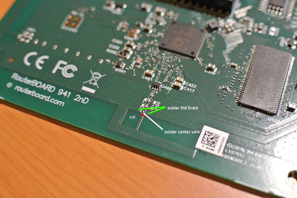

the hAP lite antenna is on the PCB and there is no connector:

I successfullly modded a RB 951G-2Hnd with 10dbi antennas and that thing is a beast. Now I’m working on a RB 951Ui-2Hnd but I was wondering if the hAP Lite can be modded too. I did some mods on USB WiFi adapters that have the same PCB type antennas (D-link Go 150, Tp-Link etc) and I think this is what need to be done, can anyone with experience confirm? (see attached pic).
When I would have to do that, my first try would be to cut the trace that you labeled “center wire” flush with the
ground plane, and solder a thin coax cable with the center conductor on the trace and the braid soldered to the
ground plane on both sides, as short as possible. Or solder a small coax connector at that position.
You should not have extra millimeters of ‘wire’ by cutting at random places such as you indicate.
Something like in the attached pic?
Leave the extra ground trace uncut?
I know it should be as short as possible, I made the first pic for example only.

Yes. Or instead of cable/braid a SMA, SMC, MCX or similar connector (PCB/Surface mount variant that fits the trace)

That is like what I had in mind, although I would have cut the inner coax lead much shorter.
I realize this is quite late to answer, but looking at the FCC website (http://tinyurl.com/z69n77h) and clicking on internal photos, it shows a connector (uFL?) at J400.
If nothing else, it should be possible to remove the capacitor that connects the antenna to the board and solder in a connector. Lot of work but the board submitted to the FCC shows it is possible.
well that’s not a uFL connector, this connector is not supposed to connect an antenna. This is a switching connector for testing units after manufacturing and has a hole instead of pin. This is where my experience ends and yes, I know I’m replying to 4 years old thread :joy: I’m gonna do the antennas mod so I have found this thread
