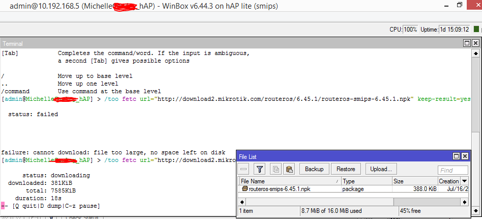

This is from a new install where I thought I could diagnose and cure the problem remotely, so I decided to upgrade the SW. You can also see the current speed issue, 381KB in 18 seconds on a 50/30 delimited Internet connection. This file is being fetched directly onto the hAP-Lite across their PPPoE connection, I did upgrade it to 6.44.3 when I was there and installed to get the PWL functionality, but now I can’t do anything!
To say I’m disappointed is an understatement as it’s hard enough trying to deploy, upgrade, maintain, expand and deal with my network as it is, without having to then start diagnosing stuff that should just work straight out of the box.
I’ve been using ROS since 4.17 so have had plenty of practice ironing out and working round issues, but this is beyond me and I’m not even going to waste anymore time. If it ain’t broke, don’t fix it, just give me something that works!
The space issue is not a big thing, just download the separate packages and apply them. There is a thread that discussed that topic on this forum.

Thanks CZFan for the answer, however, I think this is probably an issue specific to 6.44.3, but I was hoping not to have to drive out there to manually do the upgrade, as I said, I did upgrade from the stock software to get the PWL functionality, so I’m thinking I can do the same if I’m there.
