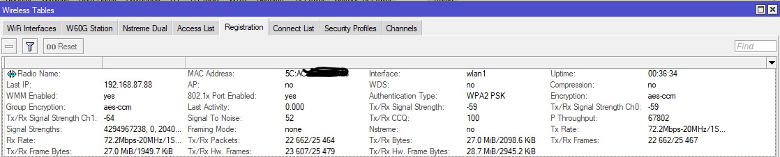

The received power at the AP and client, and the resulting interface rates can be seen in the tab “Registration” in “Wireless”.
(You may want to add more columns or use detail view, to see all information)
