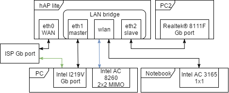

I have problem with my home WAN to WLAN bandwidth, which goes no more then ~40 Mb/s, meanwhile all other connections shows great results
*color lines means trials of connection for test.
I already spent arround a week for a various tests and expirements. I tried to disable firewall at all, configuring everything from zero and even fresh netinstall.

All other wireless devices in network working same way: good upload, terrible download, thats why I need to find a solution for it
WLAN and ethernet2-5 ports in RSTP bridge. I will post any required configuration options

i see you are marking with red color mostly the test conducted across wlan.
I think the performance its ok for a 2.4ghz radio
The most strage thing is that WLAN - LAN speed is very good, but the WAN → WLAN speed is less few times
