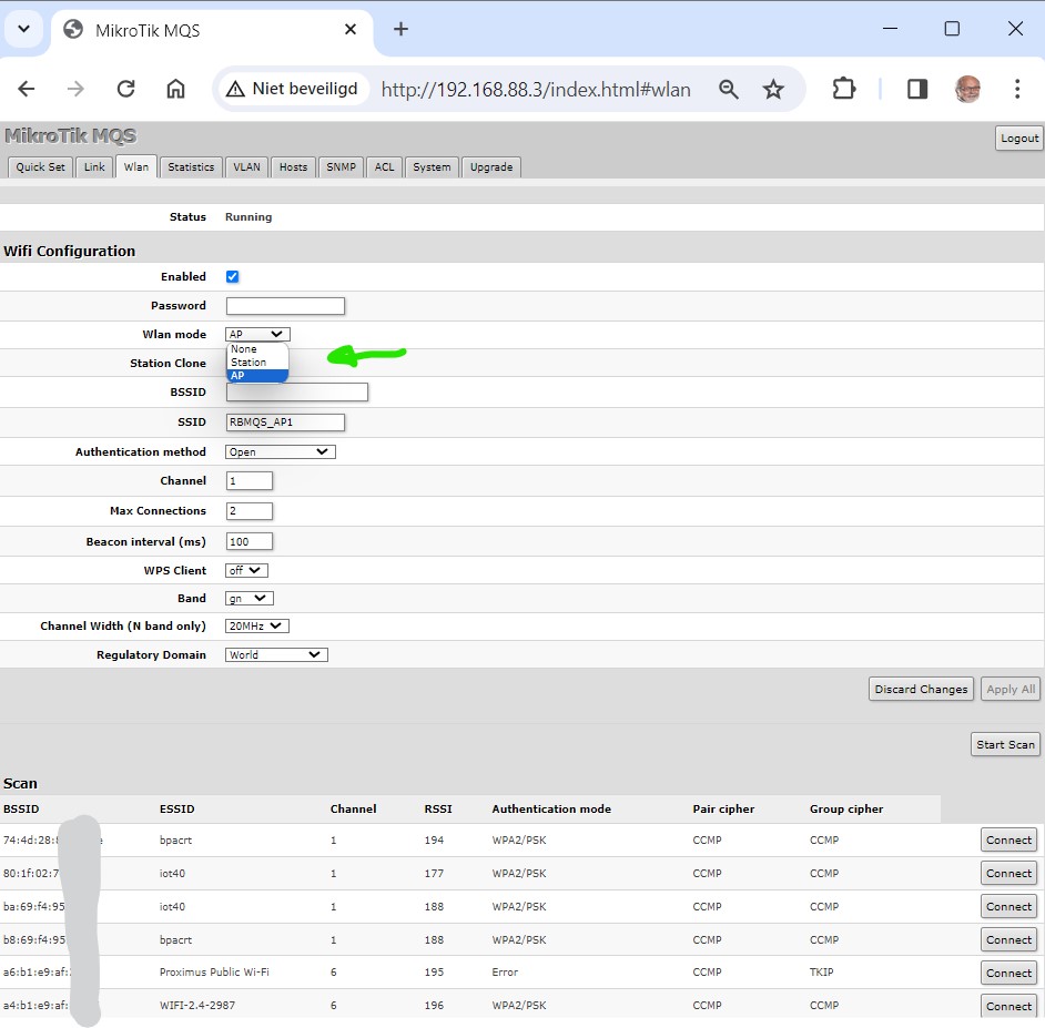

There is of course the hAP Lite, or the small mAP Lite, but even the MQS had this function. (Had … because it is discontinued, was sold as a limited AP, but is also a station.)
MQS sets the point … an ESP8266, ESP32, or ESP32-C6) will do the trick.
