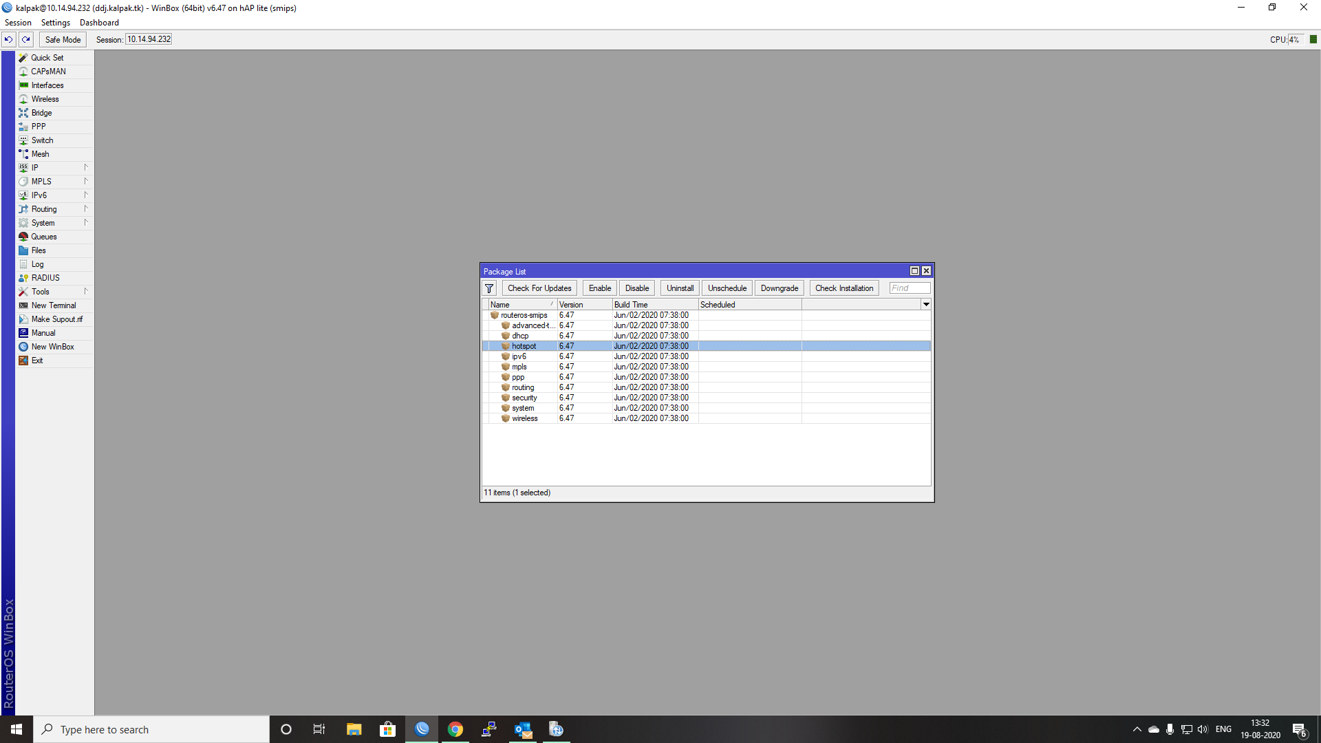

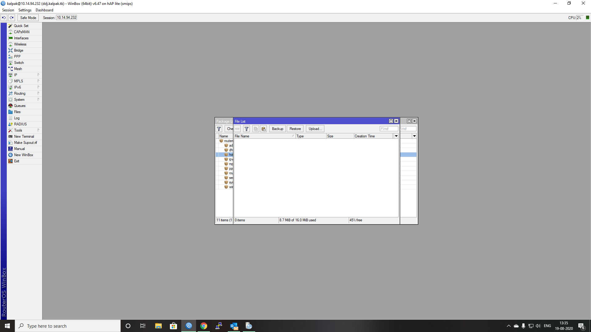

Unable to upgrade to v7.1 due to low storage. Manually copied the file yet update fails.
Files menu contains anything? Which file did you copy? What packages are installed now?

Here are the screenshots!
Put there system package only, reboot and after then install other packages you need.
I am doing that only but the package is 8mb while free space is 7.3mb so it is failing to get copied. In onld package I cannot uninstall as there are no extra packages. Only system package is installed.
