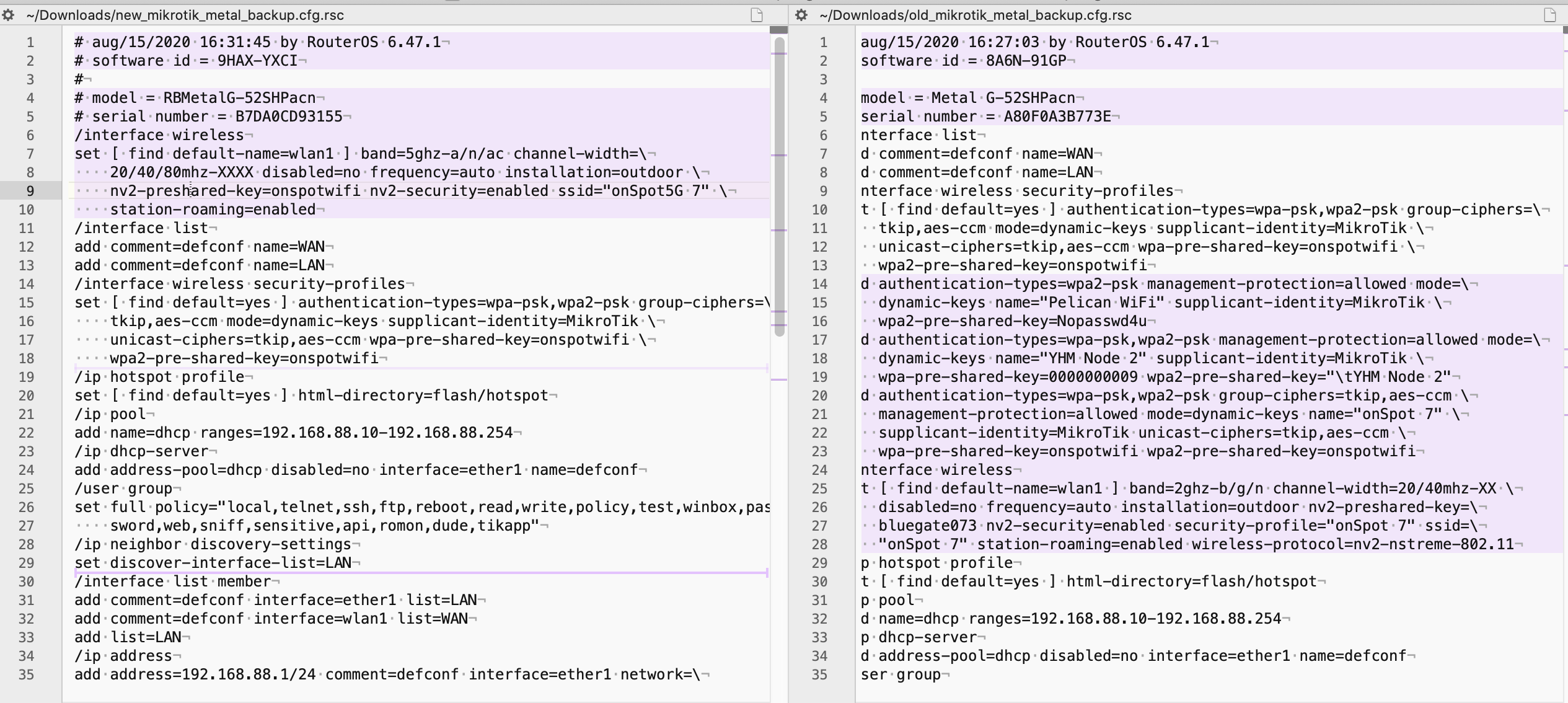

I had the 5GH radio go bad on my Mikrotik Metal 52 and had to order a new one.
I backed up / exported my configuration.
My ISP strongly suggested that I NOT use the backup to reconfigure my NEW replacement Metal 52.
I’ve configured the new Metal and got it physically installed.
I CAN use the new configuration when the Metal straight into my mac computer.
When I connect the new Metal to the HAP router (port 5) enet. I can’t get the HAP router to carry the internet traffic.
The old Metal still will carry 2.4GH traffic.
I can’t see what I’ve missed in the setup on the new metal.
What am I missing?

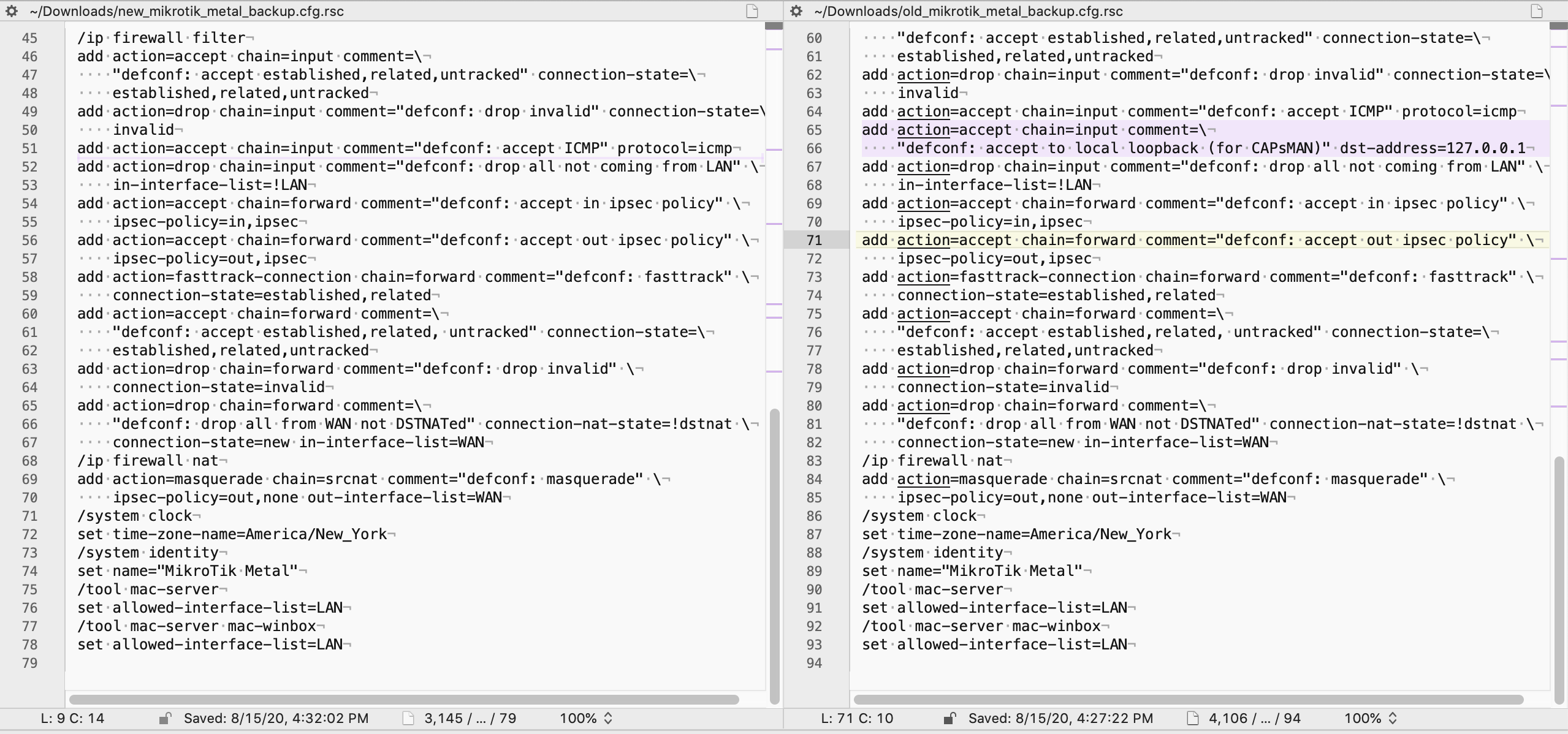

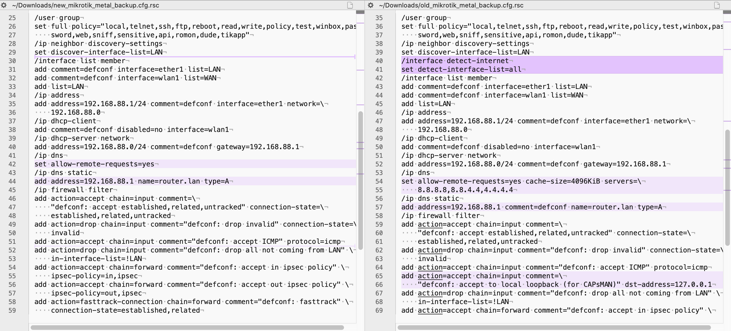

I used BBedit for a compare - there are some old configurations in the old file that aren’t in the new metal setup.
Thanks for looking!
I’ve attached three compares files.
