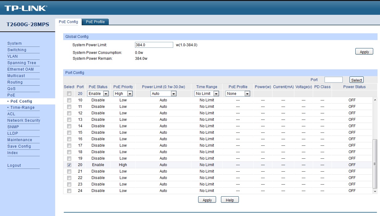

I plugged cat 5e cable @ hapAC port 1 marked as POE (poe in), at tp-link i configured at port 20 poe on, priority High and power auto.
Whatever i do, it won’t work over POE.

Your switch provides 802.3at/af PoE, the hAP expects passive PoE, so it will no work.
One option would be to use https://routerboard.com/RBGPOE-CON-HP.
Or return your switch if possible and get one that supports 24V passive PoE like the ES-24.
If 5 ports are enough, you can use the RB260GSP.
Mikrotik also announced such things at the last MUM, the CRS112-8P-4S and the CRS328-24P-4S+RM.

hapAc needs 17 watts, tp-Link can provide up to 30 watts.
Poe + is 48v , passive is 24v. :wink:
It is not only an voltage and power issue.
With 802.2af/at, the device negotiates its power level, following a specific protocol.
With passive PoE, it just gets power over the pairs 4-5 and 7-8 (24V in most of the MT and UBNT devices).
Because the device does not do power negotiation, your switch will never supply power to your device.
But, if i understood you correctly, RBGPOE-CON-HP should work in combo between tp-link and Mikrotik?
Exactly. It accepts 802.3af and puts out passive PoE.
