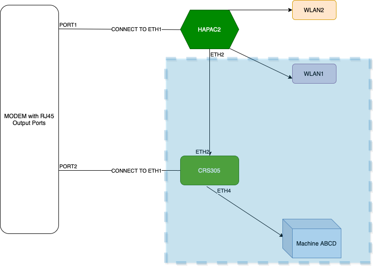

I have a Mikrotik CRS305 and a HAPAC2 . I have connected both to the ISP Modem via RJ45 . Both HAPAC2 & CRS305 have their own separate DHCP server/clients running on them.
HAPAC2 has WLAN1 & WLAN2
ISP MODEM: VIRGIN MEDIA Modem with multiple RJ45 ports to connect to router(s)
Scenario:
Current Setup
modem->–hapac2 (eth1). Hapac2 is set as dual AP (wlan1 & wlan2) wifi router which has its own DHCP serve and client
modem->CRS305(eth1). CRS305 has its own DHCP serve and client and is connected to a machine ABCD on its ETH4. Machine ABCD doesn’t have wifi access
What I am attempting to do
CRS305(ETH2)---->HAPAC(ETH2)
Expectation:
HAPAC2 wlan1-should use the DHCP server of CRS305 (and not of hapac2) . I want to isolate access to Machine ABCD only for devices connected to wlan1. Also devices connected to wlan2 should not see devices on wlan1
HAPAC2 wlan2- should use the DHCP server/Client of HAPAC2. should have no access to Machine ABCD or to anything connected to CRS305
I am trying to isolate the area highlighted in box with dotted lines in the diagram
Edit1: added more info
Edit2: Better diagram

Keep going. I read it several times and I’m still not sure what exactly you want. What is ISP modem? Is it actually a router with more than one LAN port, so you can connect two devices to it? And then you want a separate subnet behind each router? So behind hAP it should include its 5GHz wifi a maybe some ethernet ports. And behind CRS it should include its ethernet ports, and additionally clients connected to hAP 2GHz wifi?

I have once again edited the original post for clarity. To add context, I am a Roon user. This is an audio streaming server (Machine ABCD) running Roon , which is connected to my stereo. It has a Remote app I have installed on my iPhone , which I can use to control music playback (playlist selection etc) only if I am on the same network as system ABCD. I am trying to isolate this music server from all other devices in my wifi network apart from those connected to a certain wifi (wlan1)
Plan is setup up wlan1 in such a way that I can only connect to my music server if I am on wlan1. And I will only connect my iPhone to this wlan1 when using my stereo. else my stereo is isolated from other devices on my network . Hope this is better explanation :slight_smile:

This looks like a typical VLAN case where WLAN1 en eth4(CRS305) are access ports of that same VLAN, and eth2 on hAP ac2 and on CRS305 are trunk or hybrid ports for that VLAN.
VLAN config will depend on the question if you need access to the internet for machine ABCD or when you are on WLAN1 or not.
There are quite some possibilities. Now you potentially make a loop with the modem-CRS305-hAP ac2. Depending on the requirements this can stay as is or be reduced with one link.
Once requirements are clear, there are enough forum members following this who would be glad to give you the optimal corresponding VLAN setup.
(It can even be done without VLAN) Choice depends on what else you want to do with this equipment.
To refine the design, why do you need the CRS305, what other functions does it have as technically you could do without it and connect the hapac to the abcd machine.
My server connects via an SFP port. And I use the CRS305 as a FMC. I don’t wanna water your time in explaining the audio related reasons why I want the CRS305. Long story short I need it in the loop. And I want it to be a separate network.
