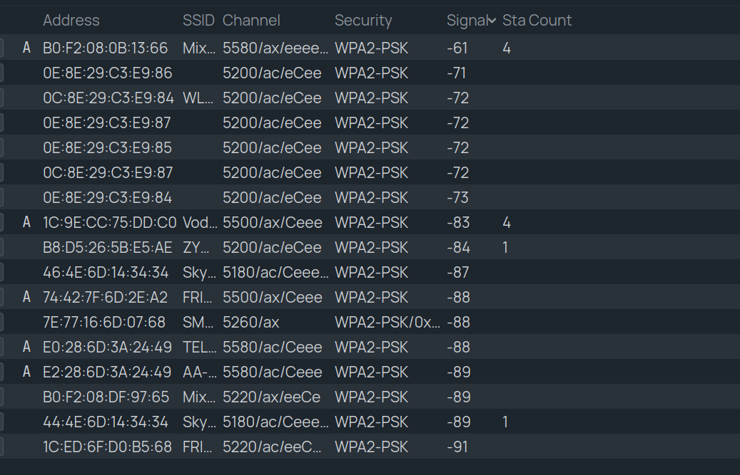

I get about -50 (sometimes -46) dB on my antenna according to the Wi-Fi → Registration Tab. The rate is also “explained”, as it defines the rate to be 229.4 Mbps at the time of writing. This varies occasionally. What worries me, is that I am in a crowded Office, with many other hotspots. But I mean, 5 GHz should be able to do 2.4 GBits, which is a far cry from 300 MBits. When I scan the 5 GHz network is see these networks:

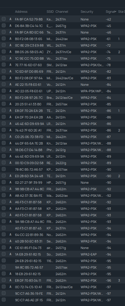

The 2.4 Ghz is far more crowded:
