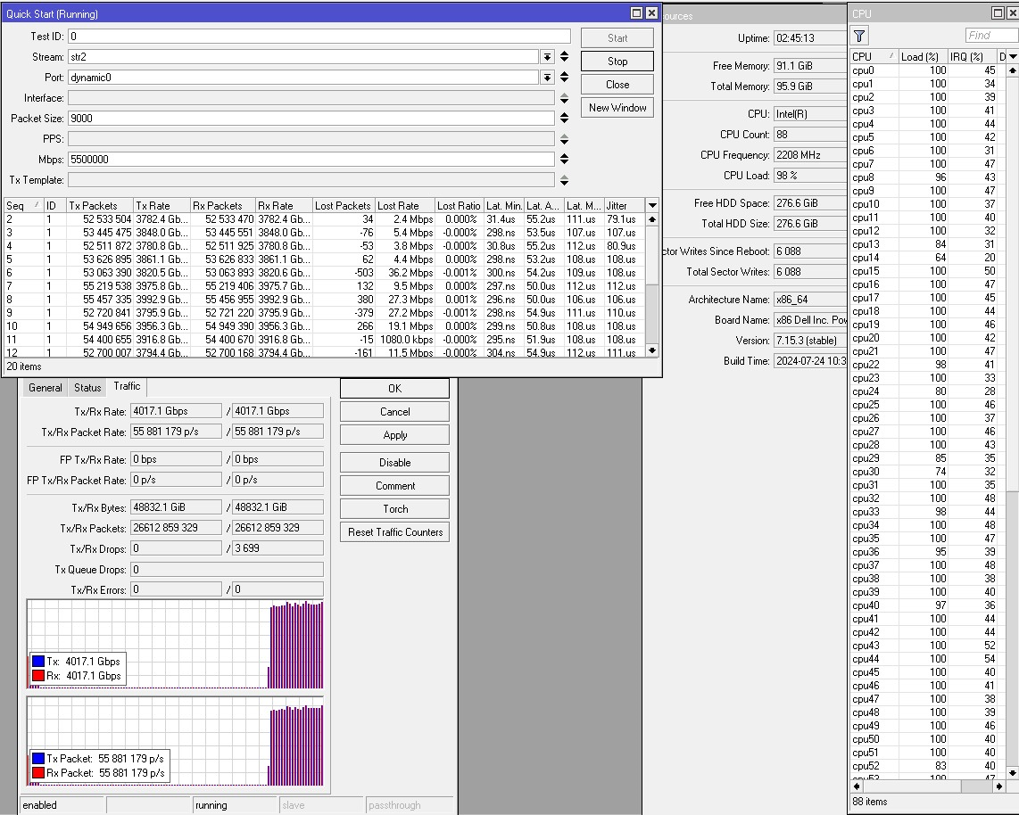

First picture is of intel x710da4 with 4 ports sfp+ using por1 all IRQ queues from port 1 beeing sent to cpu 0… hundres of thousand of packets.. which obviously generates alot of RX-ERRORS and TX-ERRORS.. simply for the fact the card cannot handle all of it.. even increasing queue size from 50 to 500 to 5000 to 10000 to 20000 still throughs errors and the higher you increase it .. the higher problems you will have with ping and other issues..
and below on the second picture is Mellanox ConnectX4 CX4121A using port1 with double the traffic around 5gbps on BGP server
with no issues and no errors at all

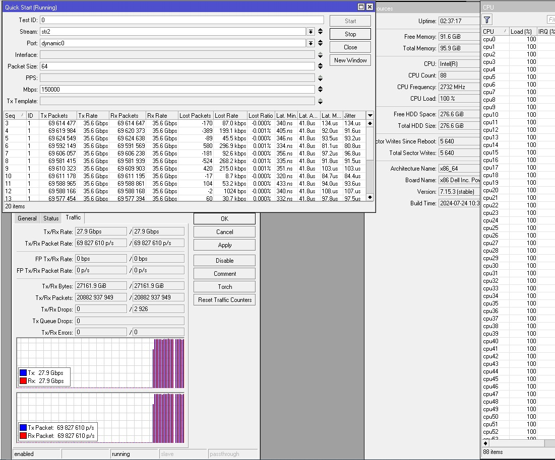

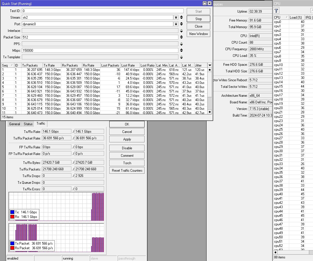

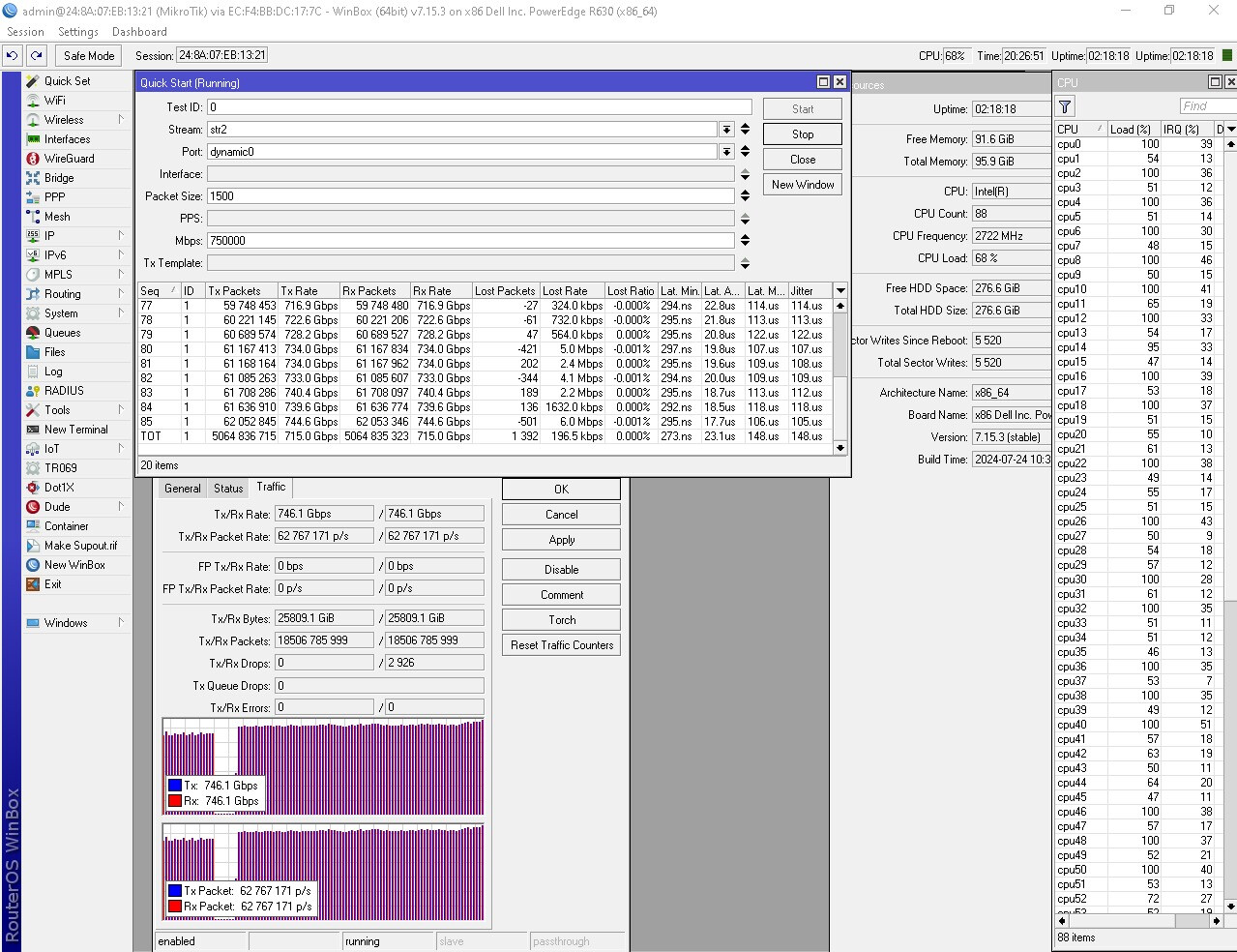

and with traffic generator using Jumbo frames we have managed to squeeze 8Terabits of full troughput aggregate… so this cpus can take alot.. for the price budget you can find them on the market today…
attached some pics
64b packages
512b packages
1500b packages
9000b jumbo frame package results from the cpu

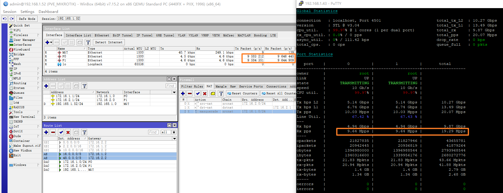

Amazing performance! Thanks for your sharing. Here is my test result. Ros 7.15.2 running on PromoxVE 8.2.7. I got 19.29Mpps throughput without firewall config, tested by Trex 3.5. Hardware platform is E5-2697A V4 with Mellanox MCX4121a NIC. A tiny ITX box.
