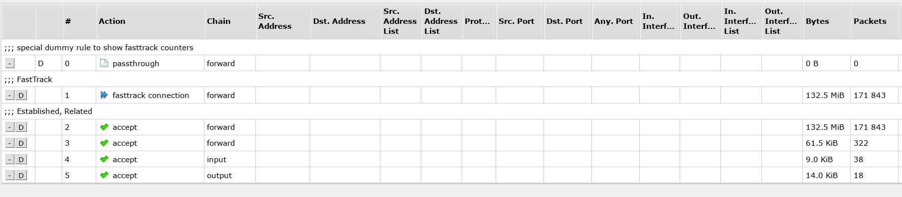

Counters being non-zero for firewall rules “special dummy rule to show fasttrack counters”.

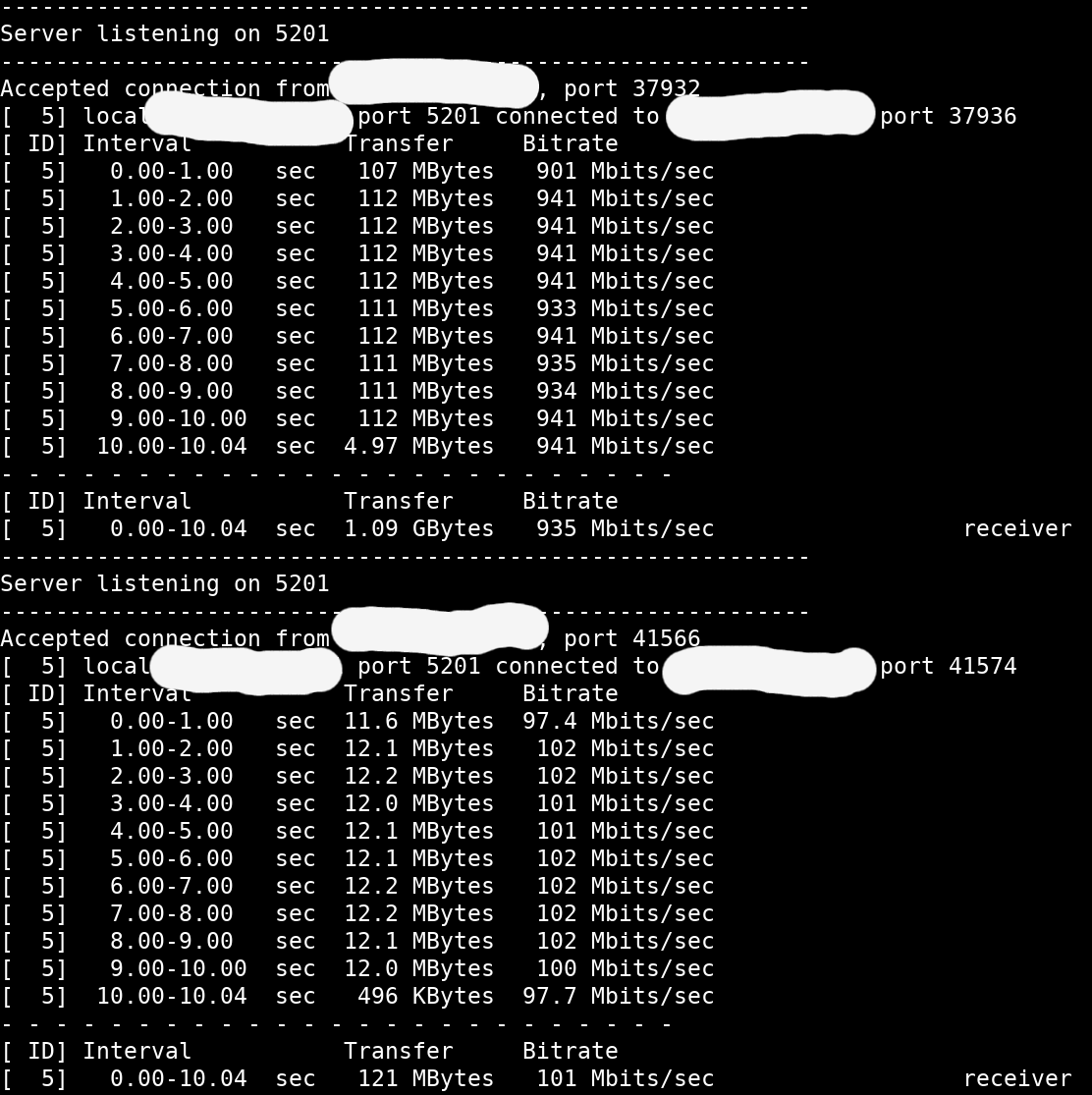

Getting about 950Mbit/s going from ether2->ether3 with iperf3
Getting slightly under 100Mbit going from ether2->ether1->outside with iperf3 (CRS326 managed ~350Mbit due to faster CPU in the same situation)
Bypassing the CRS354 gives 950Mbit.
Counters for firewall rule “special dummy rule to show fasttrack counters” stays at 0, same for those counters under mangle.

add action=fasttrack-connection chain=forward comment=FastTrack connection-state=established,related hw-offload=yes
add action=accept chain=forward comment="Established, Related" connection-state=established,related
add action=accept chain=input
add action=accept chain=output
Then doing iperf3 ether2->ether1->outside => ~100Mbit.
set [ find interface=ether1 ] hw=yes
Same iperf3 => ~950Mbit, but this skips all the firewall rules.

Hi StricUmea,
The first thing that stands out:
Transparent firewall with FastTrack for “connection=established,related” and very few other firewall rules. No routing/NAT, only bridge/switch.
Bridged traffic by default is not passed through the IP firewall and connection tracking. Yes, you can enable the “use-ip-firewall” under the bridge settings and pass the L2 traffic additionally through the routing chains (prerouting, forward and postrouting). However, this requires that bridged packets are forwarded on the software bridge (CPU), not ideal for the CRS354 switch. Traffic that is forwarded in HW offloaded bridge will not get passed through routing chains, even with enabled “use-ip-firewall”.
In addition, “use-ip-firewall” disables the bridge fast-path feature, which will affect the ability to properly FastTrack connection going over the bridge.
This setup is possible, but only running on the CPU. If you have a CRS354 switch, a much better alternative would be to use switch ACL rules. Or convert the setup from the bridged/switched to routing with connection tracking (supported by L3HW).
