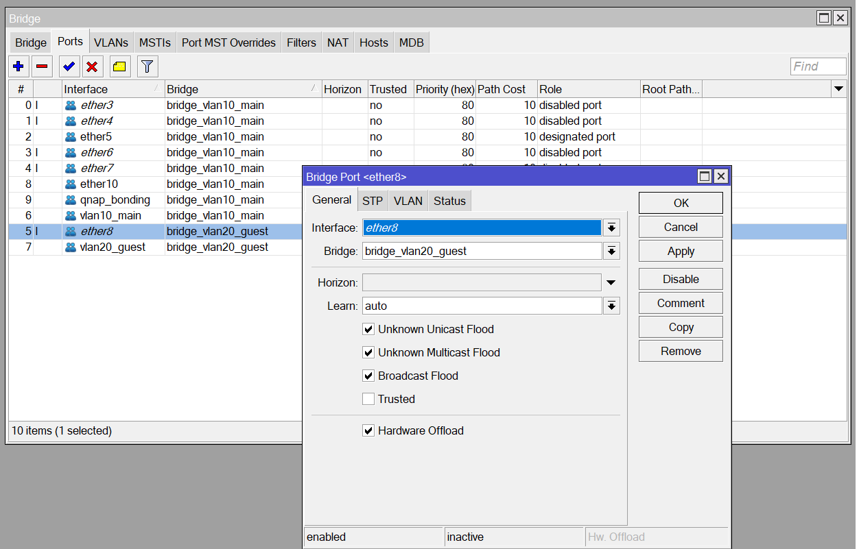

HI guys,
I just realised that non of my bridged ports are hadrware offloaded, even thought the option is ticked, can somebody please explain why?
thank you
HI guys,
thank you
Maybe this (from https://help.mikrotik.com/docs/display/ROS/Switch+Chip+Features):
By default, the bridge interface is configured with protocol-mode set to rstp. For some devices, this can disable hardware offloading because specific switch chips do not support this feature. See the > Bridge Hardware Offloading > section with supported features.
When will MT make hw offloading available for the majority of frigging routers…
