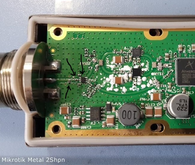

Hi friends, I really need help. For me has been impossible to find the datasheet of the Mikrotik Metal 2SHPn, I can undestand, but, if any one has some experience repairing this Routerboard, please I need help.
Here I send you a picture with the parts broken (black arrow), I need to know what kind of components are this and the ID of this componet for repair.
I will be always gratefull for any help in respect this. Thabk you in advance and God bless you

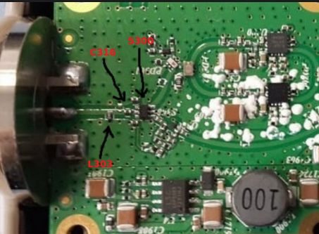

Hello @riestra
The components you are looking for are L303; C316; S300
S300 = SPDT RF Switch, GaAs MMIC 0.5-2.5GHz 6pin 2x1.25mm
P/N: UPG2009TB-E3-A
C316 = Capacitor 12pF ±5% 50V NP0 0402
L303 = Wire wound Inductor 18nH ±5% 420mA SRF-3.1 0402
