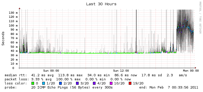

My smokeping graphs look like hell comparing to the graphs of other machines not being filtered. Have a look at the attachment.
