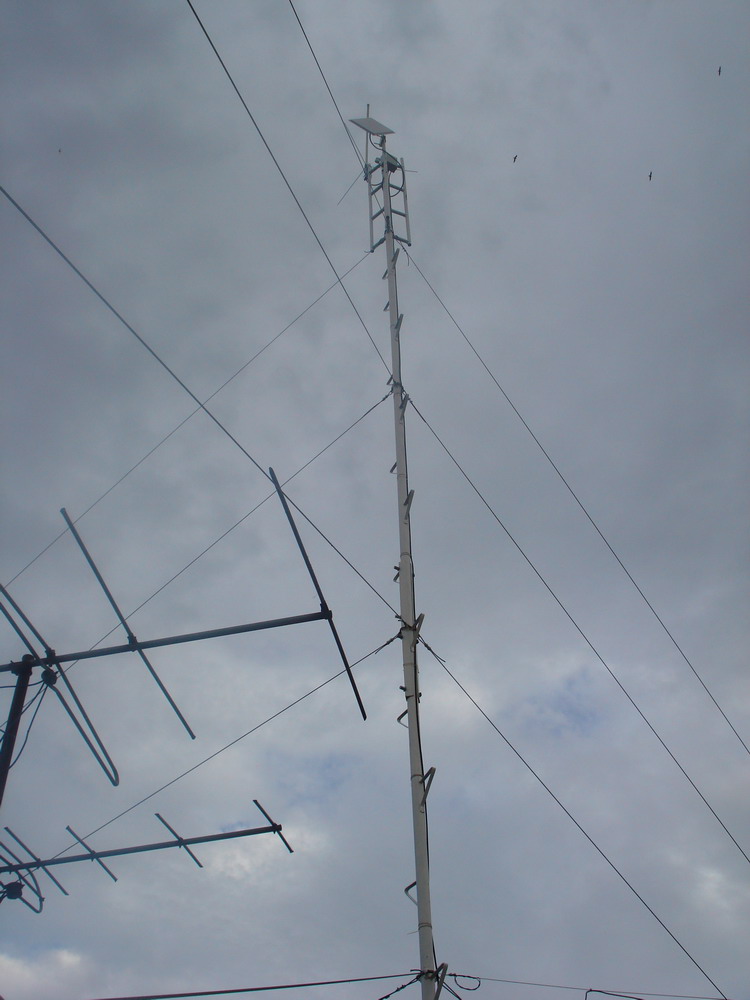

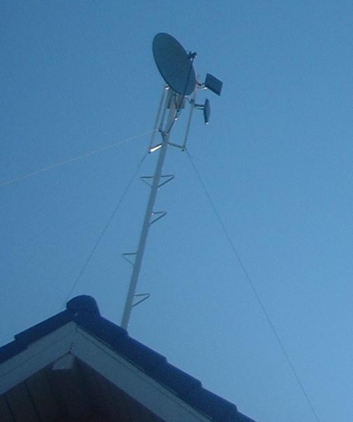

Tipicaly I use integrated solutions, N-type connectors need clear each 1-2years. Towers I make always myself, welding equipiment and 2-3 day work and I got 12-18m servicable tower depend on my requiremet. For example 12m tower cost not exceed some 90-100$ There is some photo If you locate somewhere nearly I can make one for you with good price :slight_smile:)
