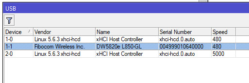

Hi everyone, since I have always had problems with R11e-LTE6 modem through firmware up to v035, carrier aggregation issue, link down every 15-20 minutes, just fix one band works well, I decided to try Fibocom L850-GL, supported since RouterOS 7.7 .
At first it was not recognized
but after firmware update it is recognized (MBIM mode) but still not working well, AT commands don’t work, no internet connection…

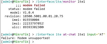

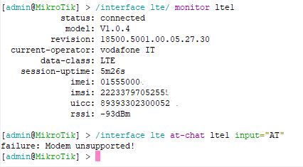

With RouterOS 7.11 in changelog they mention with “lte - added “at-chat” support for Fibocom L850-GL modem;”
but I’m tested at-command with L850-GL on hAP ax3 and hAP ac2 It’s still not working
What happens? e.g. an error message, or is the “at-chat” command not there, etc?
Also does the modem work otherwise?
It’s return message with “failure: Modem unsupported!”
for the modem status connected and the internet is ok
Try a /port print to see if there is a serial channel for usb1 and how many channels it supports. Assuming there is at least one channel, you can try:

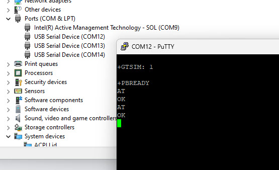

I try to connect USB modem to PC and use putty to input the at-command It’s work fine.
Finally it works by FW 18500.5001.00.05.27.16 and 7.12 RouterOS
Some cell settings limitations, but by default it works fine in CA, no more link down and x3 speed, from 50 to 150Mbps!, compared to standard R11e-LTE6 modem.
