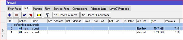

  1. I was using the one masquerade default rule to cover off both WANS I have, cable and fibrop. This was done by stating both VLANBELL and Cable were on the WAN Interface List and then in the Masquerade rule stating the OUT-INTERFACE LIST as WAN. Just in case this was not good enough I used the OUT-INTERFACE tab and put each WAN as a separate masquerade rule.

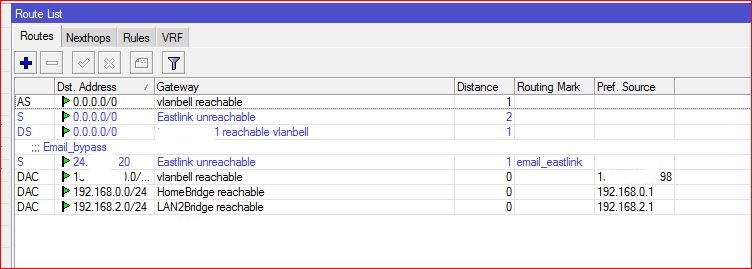

  2. I also created two ROUTES, one for each WAN, first was vlanbell with distance of 1 and ping gateway, second was cable with distance of 2.
    I did notice that the router tends to create its own routes anyway and I hope it knows to follow my failover routing attempt.

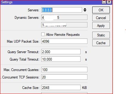

  3. For DNS the only funky thing I did was add google 8.8.8.8 as a DNS server.

Those routes are confusing to look at, can you first remove the “add default route” option if you are specifying your own? I haven’t pulled off your RSC file yet but will do (shortly) to see how you are connecting on the WANS but if they are DHCP client or PPP clients then there is an option to not add default routes.
That will then the box out a bit for you and make things easier to pick through from your routing perspectives.
You’re absolutely on the money with how your failover should work, distance 1 with check gateway and second route as distance 2.

I kind of meant to get rid of the router generate default routes. As you are creating your own then you don’t need them and they may be working against you. I think looking at your RSC file you have a dhcp-client on both an ether and a vlan, edit those dhcp-clients and select no to add default route. That should clean your routes table up a little.
Traffic won’t start going through it simultaneously as you have the setup as master-failover. If you temporarily disable the main gateway the ip route table should change your bell route to black and start working.

What is interesting is that when I run a PC diagnosis on the network the problem is stated as not being able to resolve DNS.
This makes me think that disabling remote DNS is perhaps an error.
  1. Should I
    a. make the gateway for each LAN, 192.168.0.1 and 192.168.2.1 respectively, the DNS address
    b. turn on remote DNS entries, something about caching being faster as well.
(from my compact config currently have
set servers=8.8.8.8
/ip dns static
add address=192.168.0.1 name=router.lan )
  1. Also noted is the masquerade rule I have
    ( ip firewall nat
    add action=masquerade chain=srcnat comment=“defconf: masquerade”
    out-interface=Eastlink
    add action=masquerade chain=srcnat out-interface=vlanbell )
would it be better NOT to state the out-interface??
and instead
add action=masquerade chain=srcnat comment=“Homelan”
source address, 192.168.0.0/24, destination address 0.0.0.0/0
add action=masquerade chain=srcnat comment=“DMZlan”
source address 192.168.2.0/24, destination address 0.0.0.0/0

Under IP>DNS check “Allow Remote Request”. With out this checked your devices can not use the router for DNS. Just be sure that your firewall rule block DNS request from the internet.t
Hi 2 frogs I checked allow remote requests with no luck. Yes I have RAW prerouting rules to drop tcp/udp 53.

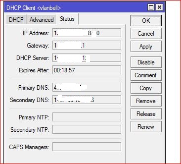

Another thing I see is your routes. Instead of using the interface name, use the gateway ip given under dhcp-client status.

  1. Created static routes
    (destination 0.0.0.0/0, gateway vlanbell, distance 1 ping gateway)
    (destination 0.0.0.0/0), gateway EASTLINK, distance 2
At this point I noted that even though I put in static routes, the Cable connection I had seemed to create its own route anyway. (HINT).
By the way 2 frogs, if one sets up a static route rule for a dynamic IP address, putting in the GATEWAY and Destination as I have make way more sense, than after the fact, everytime there is an IP change to have to go back and change the ISP IP address

WHERE IS THE DEFAULT ROUTE RULE PROGRAMMED. I want to see what is so fricken special about this route rule that works whereas the static route I create do not work.
The default route can be found in IP>Routes. In one of your screenshots you posted originally, the default route is the the third one down. It has a flag of “DS”. The “D” = Dynamic, and is what is created when use default route is checked. You might note on that screen shot and on that default route you marked out the gateway IP. The interface name that is beside the IP you marked out gets filled in automatically.
Again if you set your default route as:
0.0.0.0/0 gateway=(IP address) the route will work.
Hi Two frogs. the point is that I do not want to use the default route from the router.
I want to create either one or two static route(s) and UNCHECK use default route under the DHCP client selection.
BUT my static route of
destination: 0.0.0.0/0
Gateway: Eastlink
is not working :frowning:
I am suspecting that using the Interface name under gateway is not the right move??

Again, you have to use gateway ip in your static
routes!!!
Edit: I see quotes are not working properly…
Your routes should be like:
Gateway: 1.2.3.4
Distance: 1
Ping gateway: yes
Gateway: 5.6.7.8
Distance: 2
