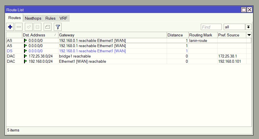

I would need to see your ip routes ??
Just type them in as they show on your router under iP routes the WAN ones,
but change any public IP numbers to something else
Attached Ip Routes Screenshot
0.1 is my TPlink ER605 Loadbance Router
1.1 is an ISP router which connected to the WAN 1 TP-Link Router
8.1 Is my 4G SIM DataCard which is connected to ER605 USB Port and TL TP-Link ER605 everything works fine only when the client connects via hotspot with RB450G having an issue until I’m not switching Off or unplugging my WAN 1 ISP cable or Router.

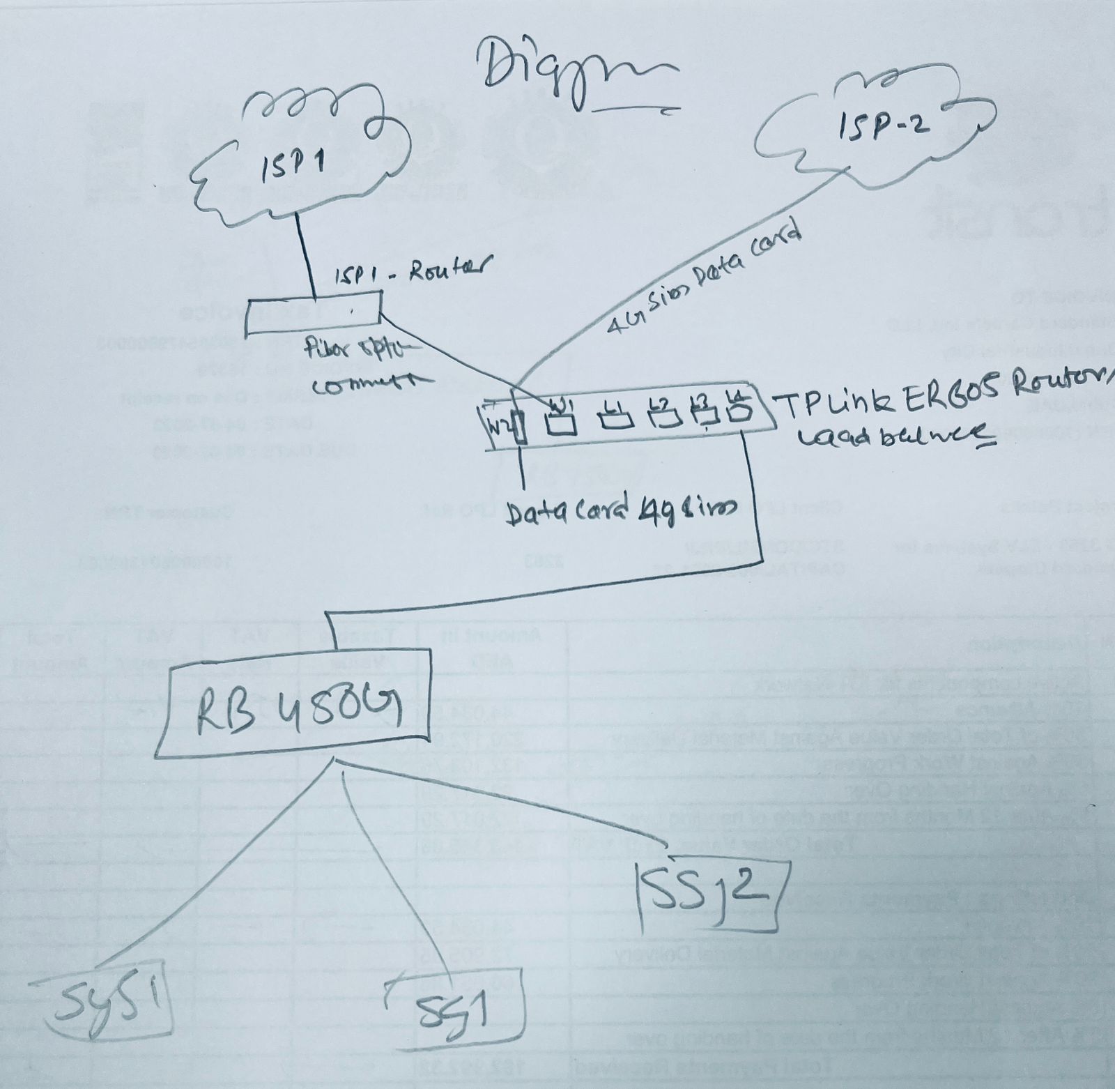

Definitely need a diagram dont understand your network to rb 450B to tplink scenario at all…

Looks like a few redundant default routes in there. I see you have some extra routing tables, but for example, in your main table the two lines here
2 A S dst-address=0.0.0.0/0 gateway=203.xxx.xxx.xxx gateway-status=203.xxx.xxx.xxx reachable via pppoe-out1 check-gateway=ping distance=4 scope=30 target-scope=10
3 DS dst-address=0.0.0.0/0 gateway=203.xxx.xxx.xxx gateway-status=203.xxx.xxx.xxx reachable via pppoe-out1 distance=4 scope=30 target-scope=10
are the same. One is dynamic from PPPoE and the other looks to be one you made with a check ping. It won’t necessarily break it, but it makes for a tough read.
Hi @emotivci,
Thankyou for your reply but I’m not currently using PPPOE only hotspot in use.
Kindly find the attached network diagram for your understanding hope it will clear things up here.
TP-link is used for load balance only the rest of the users are connected via RB450G with hotspot authentication.
Based on the diagram, how is it you have two ISPs coming in on one cable to the RG450?
You would need them to be coming over two VLANS, or use two ports on TPLINK and two ports on RB450 for WAN.
Hi @Anav,
TP Link is the loadbalance device its loadbalance my 2 WAN and via lan my RB450G is connected, i have connected other devices with TP link like one spare wifi router but its works fine only the RB having issue.
So the RB450G only has one WAN, because its actually getting a private LANIP from the TPLINK which does all the load balance.
So you dont have multiwan on RBG, you have a single private static IP WAN.
The issue is not the MT its the TPLINK then??? The MT doesnt do any switching.
I though this too but when i connect Other normal wi-fi router and system directly to TPLink its works fine no issue only RB having issue i thought RB have some short of setting which i need to fine tune and all,
