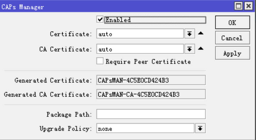

router settings:
[admin@MikroTik-Router] > caps-man interface print
Flags: M - master, D - dynamic, B - bound,
X - disabled, I - inactive, R - running
 #      NAME                  RADIO-MAC         MASTER-INTERFACE
 0 M  XI CAP-AP1-2.4G          E4:8D:8C:4B:27:73 none
 1 M B  CAP-AP2-2.4G          E4:8D:8C:72:C8:49 none
 2 M  XI CAP-AP2-5G            E4:8D:8C:72:C8:48 none
[admin@MikroTik-Router] > caps-man provisioning print
Flags: X - disabled
 0   radio-mac=E4:8D:8C:4B:27:73 hw-supported-modes="" identity-regexp="" common-name-regexp=""
     ip-address-ranges="" action=create-dynamic-enabled master-configuration=2.4G
     slave-configurations="" name-format=cap name-prefix="2.4G-APs"
 1   radio-mac=E4:8D:8C:72:C8:49 hw-supported-modes="" identity-regexp="" common-name-regexp=""
     slave-configurations="" name-format=cap name-prefix=""
[admin@MikroTik-Router] > caps-man configuration print
 0 name="2.4G" mode=ap ssid="UNI-MikroTik" country=china security=WAP2-AES
   datapath.bridge=bridge-local channel=2.4GHz
[admin@MikroTik-Router] > caps-man channel print
 0 name="2.4GHz" band=2ghz-onlyn
[admin@MikroTik-Router] > caps-man security print
 0 name="WAP2-AES" authentication-types=wpa2-psk encryption=aes-ccm group-encryption=aes-ccm
   passphrase="password"
NO ACL.
[admin@MikroTik-Router] > caps-man remote-cap print
 # ADDRESS                                                     NAME        STATE            RADIOS
 0 E4:8D:8C:72:C8:47/55454                                     CAP-E48D... Run                   1
[admin@MikroTik-Router] > caps-man radio print
Flags: L - local, P - provisioned
 #    RADIO-MAC         INTERFACE               REMOTE-CAP-NAME              REMOTE-CAP-IDENTITY
 0  P E4:8D:8C:72:C8:49 CAP-AP2-2.4G            CAP-E48D8C72C847             MikroTik-AP2
No registration table.

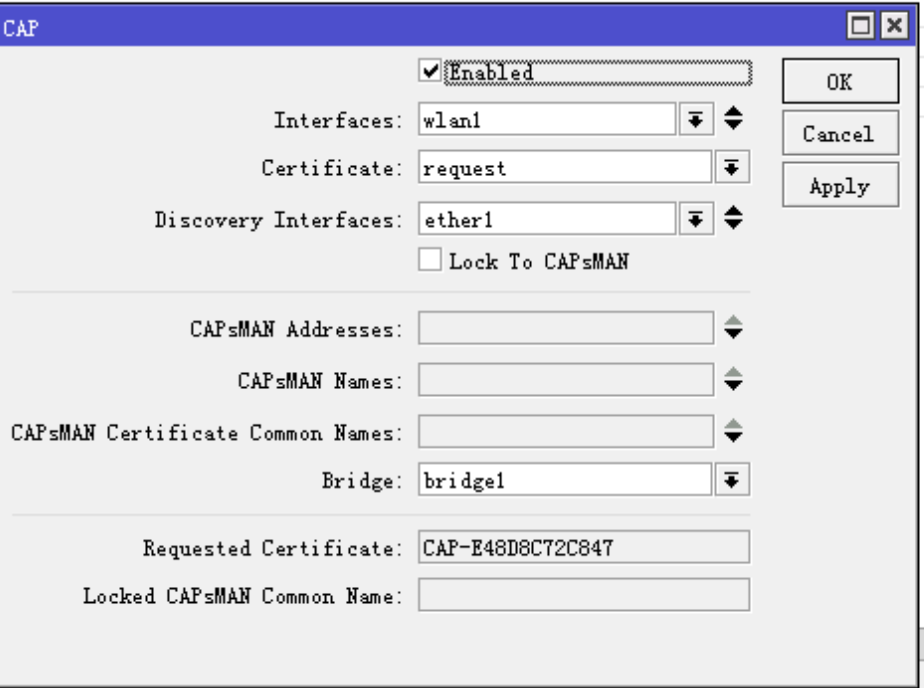

On wAP ac
[admin@MikroTik-AP2] /interface wireless> print
 0  R ;;; managed by CAPsMAN
      ;;; channel: 2442/20-Ce/gn(20dBm), SSID: UNI-MikroTik, local forwarding
      name="wlan1" mtu=1500 l2mtu=1600 mac-address=00:00:00:00:00:00
      arp=enabled interface-type=Atheros AR9300 mode=ap-bridge
      ssid="UNI-MikroTik" frequency=auto band=2ghz-onlyn
      channel-width=20/40mhz-Ce scan-list=default wireless-protocol=any
      vlan-mode=no-tag vlan-id=1 wds-mode=disabled wds-default-bridge=none
      wds-ignore-ssid=no bridge-mode=enabled default-authentication=yes
      default-forwarding=yes default-ap-tx-limit=0 default-client-tx-limit=0
      hide-ssid=no security-profile=default compression=no
