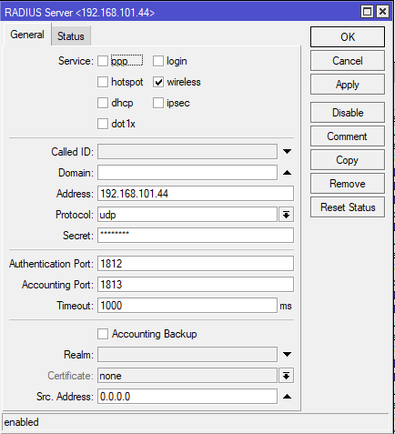

These are the RADIUS settings:

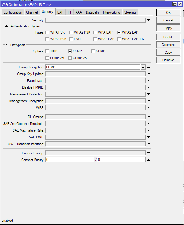

This is the security tab under Wifi Configuration for the configuration in question:
Help would be GREATLY appreciated. I’ve been trying to figure it out for a while now but can’t seem to get it to work.
I m having the same issue. It seems this will not work at the moment because of the issue with vlan tagging on 7.13.
I’ve upgraded to v7.14beta3 but still getting the same error. Wifi works wonderfully when using PSK but unable to find the radius server when I enable RADIUS :frowning: .
