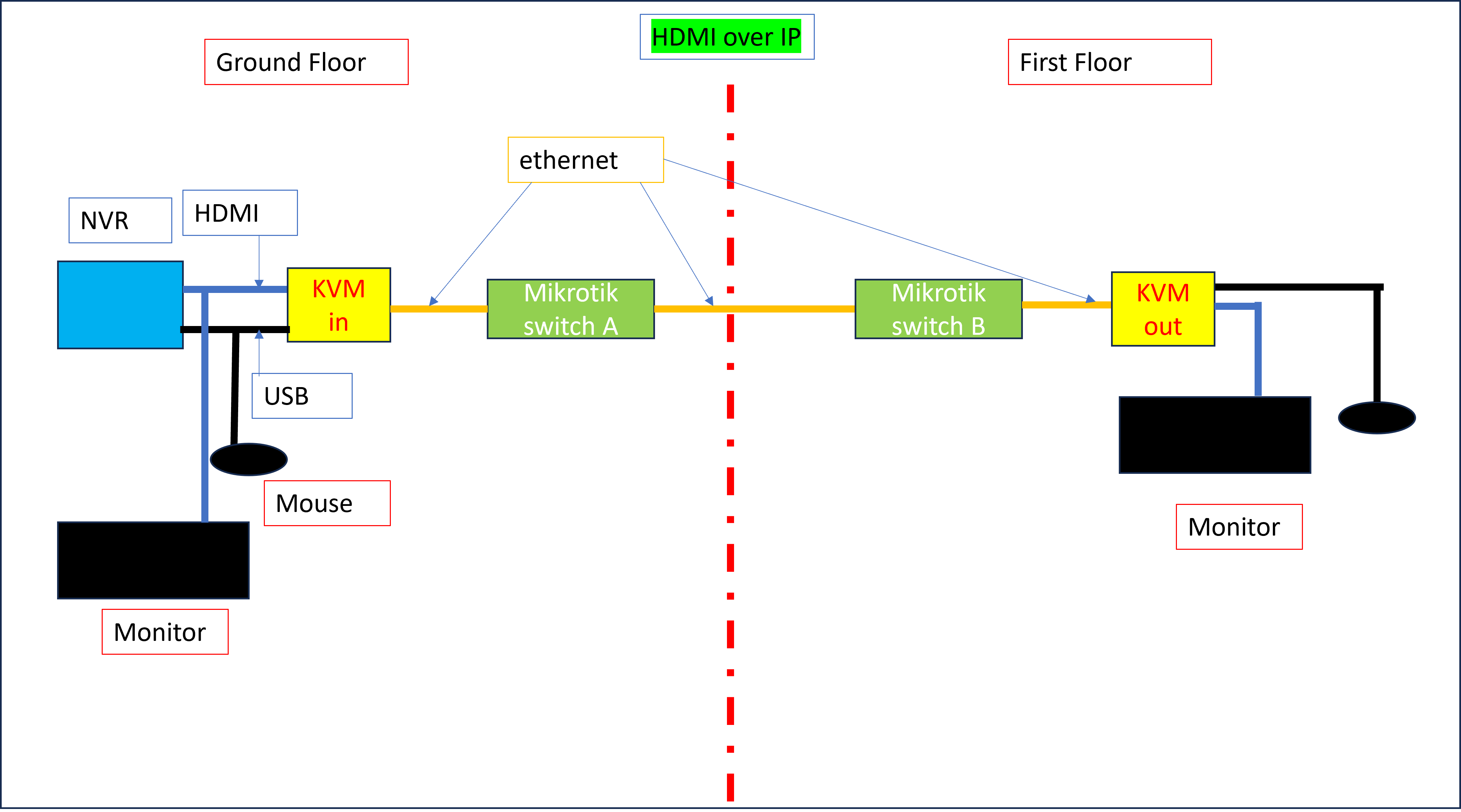

I would like to replicate my NVR monitor setup currently on the ground floor also on the first floor of my home as per the attachment
the devices that I would like to use are the KVM HDMI over IP converters that will also transmit the USB data for keyboards and mouse.
according to this video: https://www.youtube.com/watch?v=aTGBrUjtRvc
the take a way from the video are the following:
  1. configure the bridge interface enabling IGMP snooping
  2. enable an IGMP querier (probably the switch A on the ground floor?)
  3. enable fast leave on the ports where the KVM devices are connected
can someone please let me know if there are any other critical point to take into account?

Start by posting the EXACT make/models of those KVM extenders.
I have used some pairs of them a couple times, and needed not anything IGMP, so maybe you are overthinking it?
Last time I used them it was a matter of plugging one device to the network near the controlled PC and the other one to the network near the controller station, like in this quick manual:
https://gzhls.at/blob/ldb/2/3/e/b/ffdb98a1ab70caeec9a0f6a96549bc780f36.pdf
It seems to me like your layout is a typical PtP (Point to Point) connection, not a PtMP (Poiint to Multipoint) one (for which IGMP may be useful or needed).

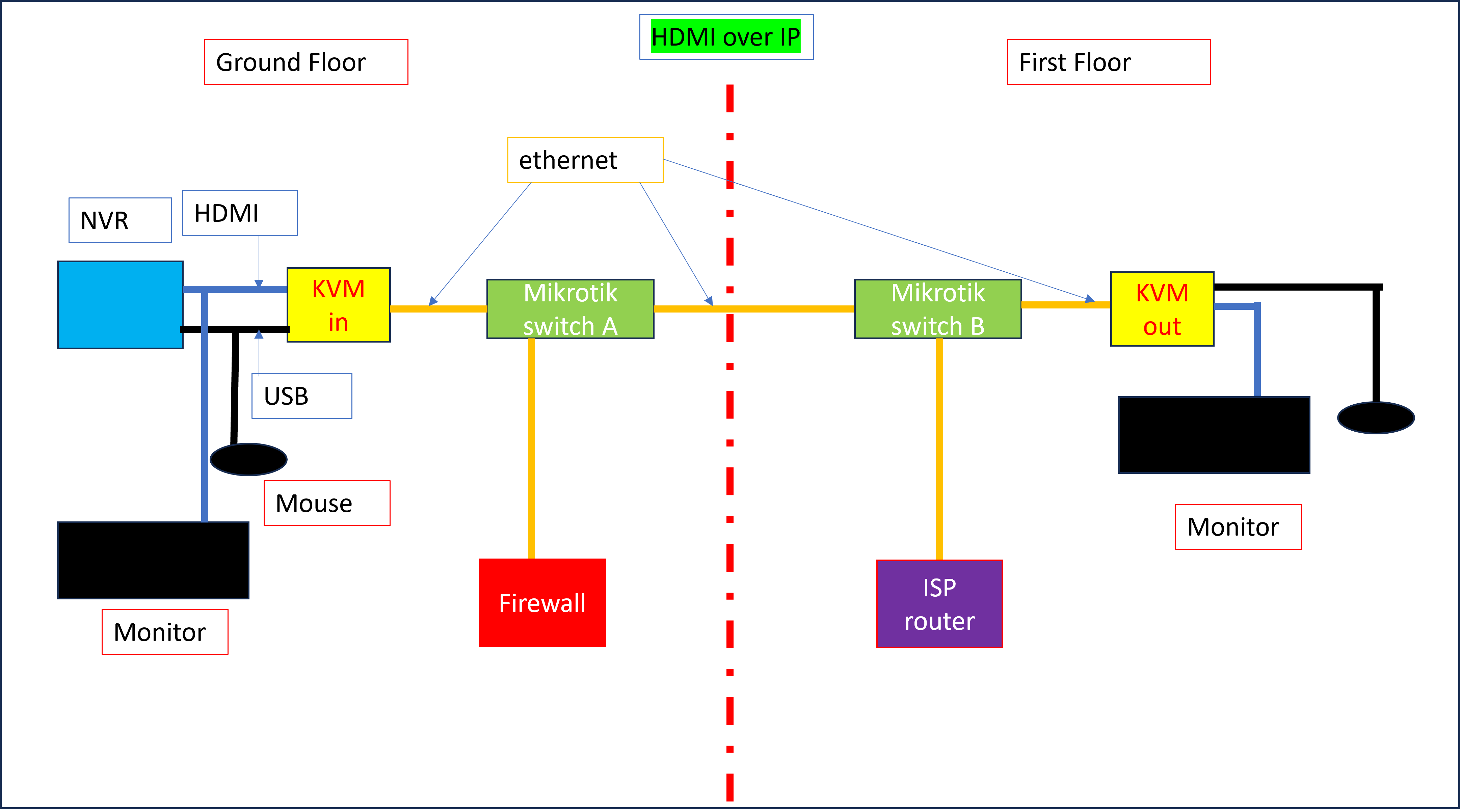

here is a more complete diagram you can see where i have the firewall and the isp router and that was why i was worried about flooding the network.

the NVR LAN is well hidden behind that Fortinet firewall and therefore network wise is on a different subnet
I agree with you it would be better to get a real IP KVM , but i honestly think at this point for a clean config… that unfortunately the Tesmart devices are best for my use case.. do you agree?
Not on the drawing you posted.
In that drawing there is a connection from the NVR to the Mikrotik switch A, and the firewall is connected to the Mikrotik switch A, not to the NVR.
But since you have two Mikrotik switches on the connection that shouldn’t be a problem, as you can use VLANs if needed.

From your drawing it is not clear which device is on the first floor, if it is a self-standing monitor+keyboard+mouse, dedicated to the NVR stuff or if it is a PC/laptop.

sorry for the misunderstanding, on the diagram I have the HDMI & USB going into the KVM and not the LAN form the NVR.
as mentioned the NVR is connecter vias ethernet to the Fortigate!
