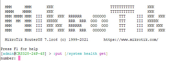

Thanks, can you also try:
:put [/system health get]
Doesn’t seam to work on ROS7

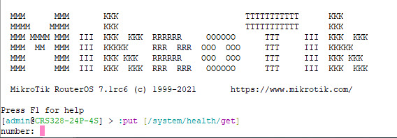

Strange, try:
It works on my CHR router:
[@M-71rc6] > :put [/system/health/get]
state=disabled;state-after-reboot=enabled
Try add all the /

Result of :put [/system/health/get]
It’s seams to be a ROS7 problem…

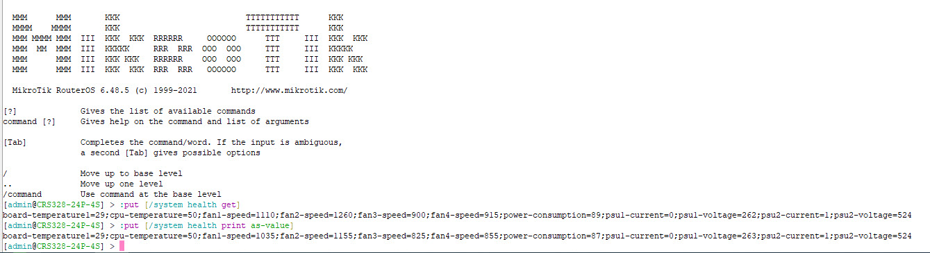

I upgrade the Swich back to ROS version 6.48.5
The Command :put [/system health get] works normally ..
Can you post a support ticket to Mikrotik about this.
What I also see in 6.x I have to devide voltage by 10. But if you look at your post for v7, it give correct voltage:
.id=*1c22;name=psu2-voltage;type=V;value=52.3
