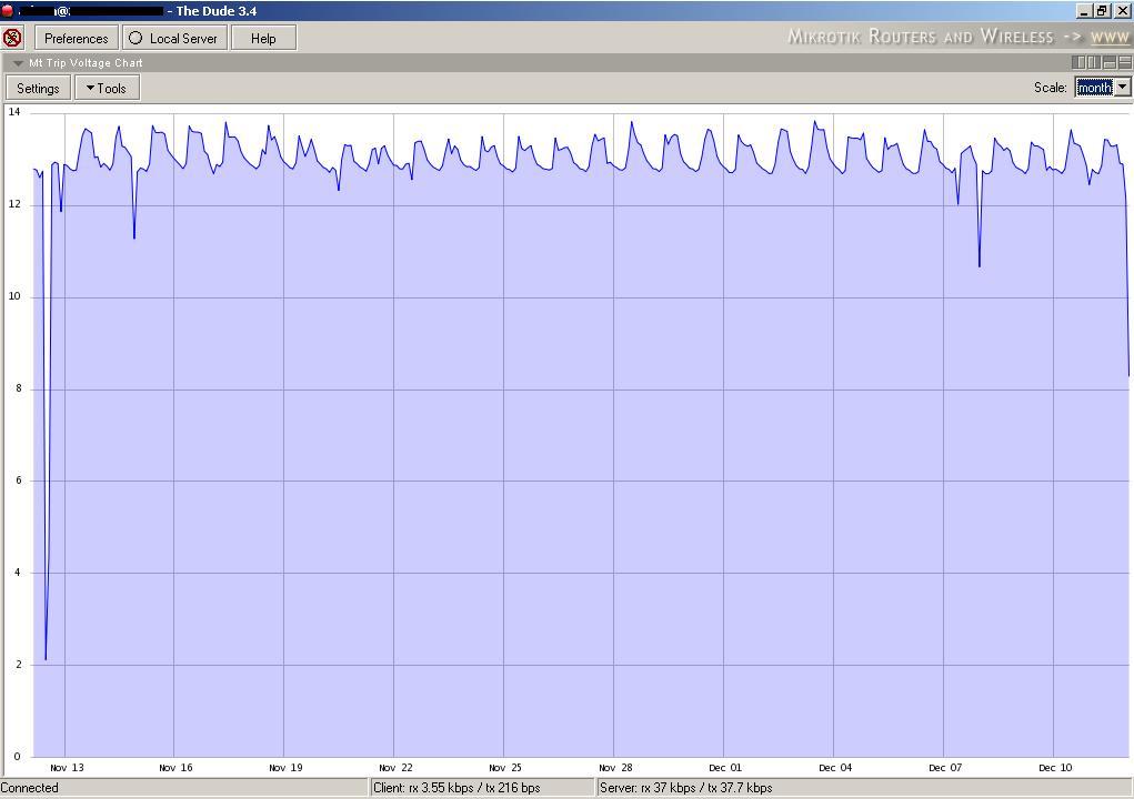

I am graphing battery voltage

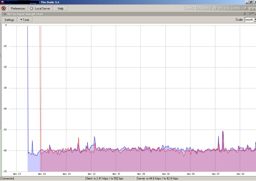

and signal strengths
with The Dude.

Nice job Matt. i have been running remote mountain top AP’s for 5 years now. One thing that has excaped me is how to monitor the remote AP’s battery supply with out a lot of costly equipment. How did you do yours?

Montana, with a 433ah, you could monitor it.
I haven’t used a helicopter yet, but we have some sites that we can only access by boat or plane. We use a mix of private boat arrangments, public ferrys, and a local flying service.
Both RB433AH and RB450G have a built in voltage monitor.
