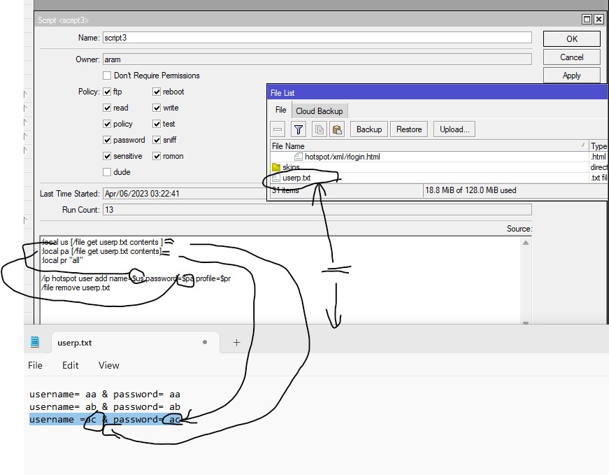

I want to create a script to create a hotspot user in a telst file that can identify the word preceded by a symbol or name, for example, like the picture I put

Thanks, but I want to script it as the picture I want the last line I specified

Thanks I want to do the work on txt I have a special reason if possible thanks again
