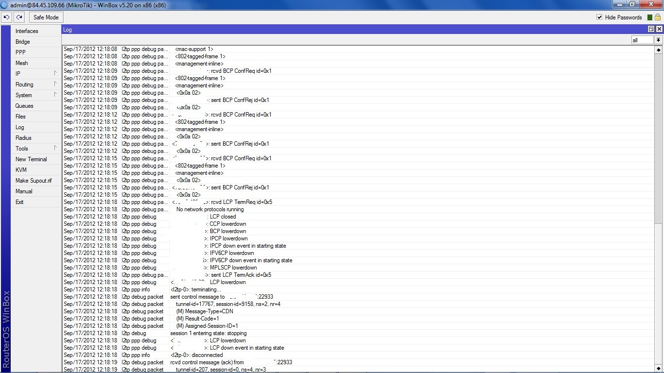

OK - So, the output that I get is that it looks as though the tunnel is establishing, but then I receive an unsupported protocol error (please see attached) - its as if the tunnel is trying to build, but never does… I have attached a screenshot of the log file (I have omitted my IP address).
The logs repeat themselves with the same message…

The attached screenshot shows the logs from this session… but I still cannot get the tunnel to build!
Any help is really appreciated.
