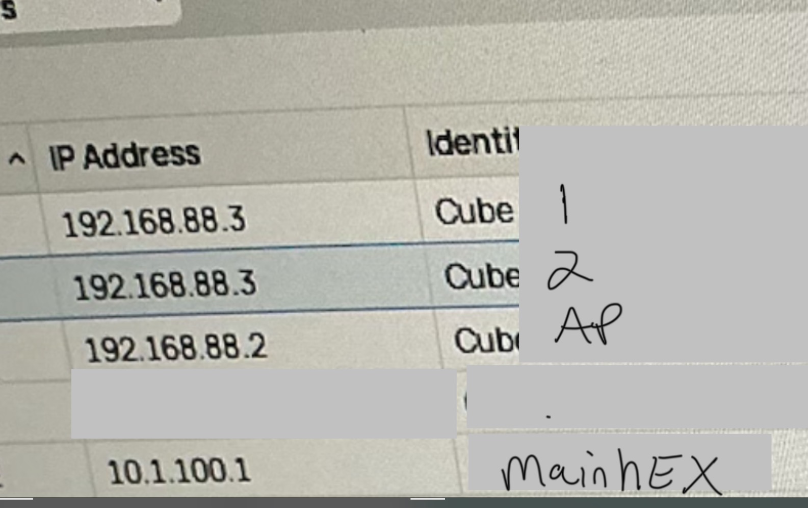

It is not clear from the picture and information you posted why you seem to have two devices with 192.168.88.3 (this is conceptually "wrong" but very likely harmless if the cube devices are set - as they normally are - as bridge [1]).
Still it is not a good idea to have duplicate IP's on a network.
It would be more logical to change the IP's of all the Cubes to addresses in the 10.1.100.0/24 so that they can be reached by normal browser connection (Webfig) from any PC on the LAN. The standard DHCP setting on Mikrotik is to start giving addresses starting from .10 (but some configs may start from .2), you could set it to give addresses in the range 10.1.100.10-10.1.100.254 and reserve:

I do see that the actual real ip is as follows: in Winbox it shows this. Not sure how to get the it switched from 192. to 10.0. thanks I do not see 192.168.88.1 only below in the picture. How do I fix this issue. Thanks again
Screenshot 2025-12-07 at 9.10.26 AM
I am not sure to understand what you are saying, but on Mikrotik devices a same interface can have more than one IP, very likely from a network that is 10.1.100.0/24 you can only see addresses belonging to it, while in Winbox you will see only the "first" address (usually it is the lowest one, but this may vary depending on how the device is setup).
Anyway, you access the device through Winbox (using MAC), and then you change/assign the IP address of the LAN facing interface (on Cubes it should be the bridge).

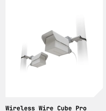

What you call "Cube AP" is a Cube SA?
https://mikrotik.com/product/cubesa_60pro_ac
And then you have two Cube Pro's connected to it wirelessly?
https://mikrotik.com/product/cube_60pro_ac
Or something else?

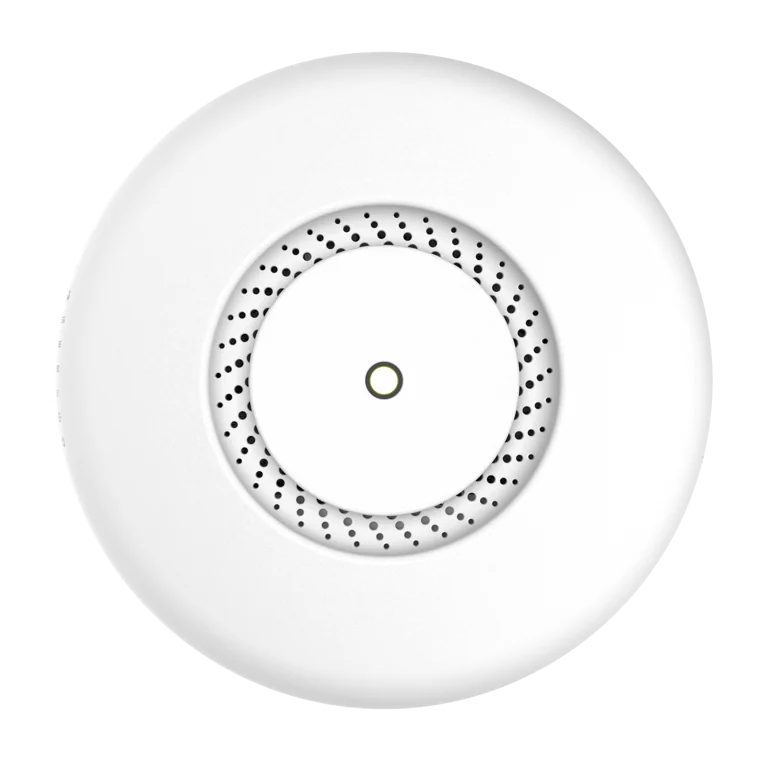

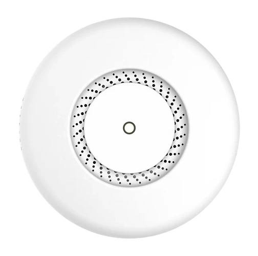

You posted a picture of a cAP AC:
https://mikrotik.com/product/cap_ac

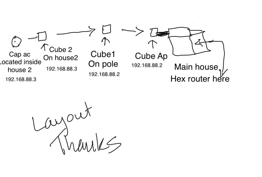

If you could post a simple diagram of your network (a picture of a hand drawn one will do) showing how the devices are connected it will help.
Also, since you can connect to the hex, start by posting the configuration of the hex.
Thanks Jaclaz they are wireline pro cube one outisde house the other wireline cube pro is on a another building.cap ac is inside the house. Thats the cube ap to cube 1 one building thenn goes to cube 2 another house and capac is inside the house connected to cube 2. Hope this helps. I will direct connect to the hex router and change my pc ip address to 192.168.88.4 should work correct? The ill be able to program the cubes to the 10. 1.100.x instead of 192.168.88.x . Thanks
Here is the diagram
