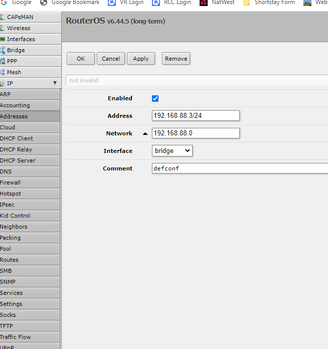

I have a wireless wire ptp network kit pre configured. I would like to change the ip address of the devices. I can login to the back end to manage them but I am not entirely clear
I found an area under ip addresses is this where it is changed? Is it changed anywhere else. Do you change the slave first then the master? I have attached a screen shot of what I can see.
Address 192.168.88.3/24
Network 192.168.88.0
thanks for helping me.
Richard
Which device is it?
Normally you change it via the QuickSet tab in the GUI.
(But then it can happen that you need to change the IP of your PC to the same subnet. Ie. know well what you are doing.)
What do you mean by master and slave?
He means AP and station.
To the OP: yes, you can change the IP there. They don’t need their IPs for the bridging to work.
I suggest you try out Winbox for management too. If you make a booboo with changing the IP you will still be able to get on to it with L2 management, and L2 management is not something you can do in the web interface.
