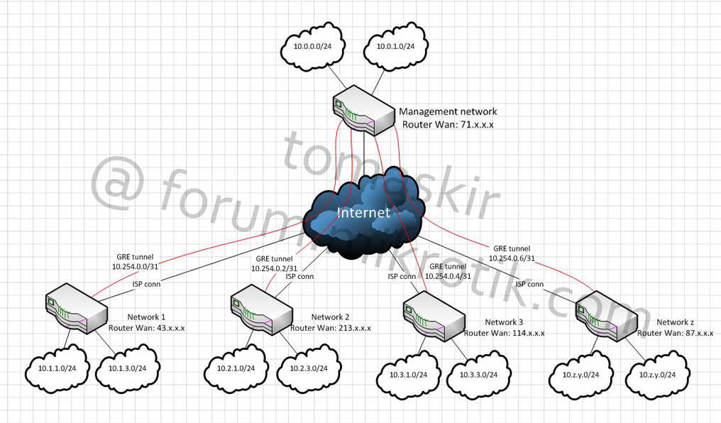

Here is how I would solve it.
All you would need to do is configure OSPF, and all routing would be taken care of. No NATing at all. Also, since if the networks wanted to communicate with each other they would have to go through the mng network router, so all the firewalling would be done in one place (mng network router)
This design would scale up to 253 networks, and each network could have up to 255 subnets behind it. Implementing IPv6 in this topology would be as easy as assigning addresses to routers and hosts and turning OSPFv3 on.
Secure the GRE tunnels with IPSec transport mode for it to be proper secure IPSec VPN.
