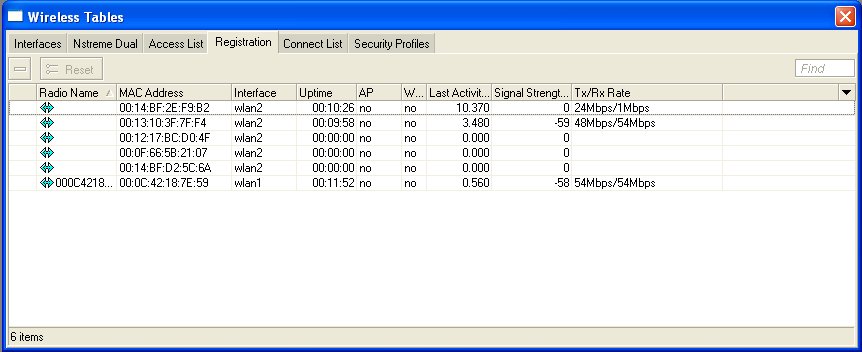

They are all in my access list, copied there from the registration list (at the time they were all associated after being rebooted).
Have also tried default authenticate, no luck.
Anyway If I disable one of them in the access list (with def.auth. false) they won’t show up in the registration list at all.
