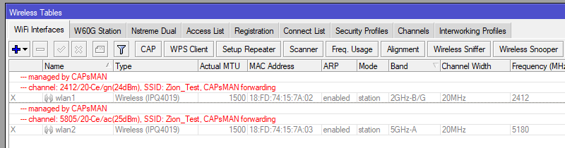

Also I’m not sure of the settings shown on the wireless table. I see the 2 red lines, but I’m not sure if that’s an error or normal. Also the line for the actual wlan has band and Frequency that doesn’t match what I’ve set.

What’s going on buddy? is it that you still are not getting the other interfaces popping up? easy fix, want to go to your capsman provisioning for me and set the action to be, create, dynamic, enabled? Has to be set to that if you would like virtual AP’s to be provisioned. The other way is to make a static cap interface manually and set the master interface to your physical one :slight_smile:
If thats not the only issue let us know a bit more on what is happening so we can assist further.
