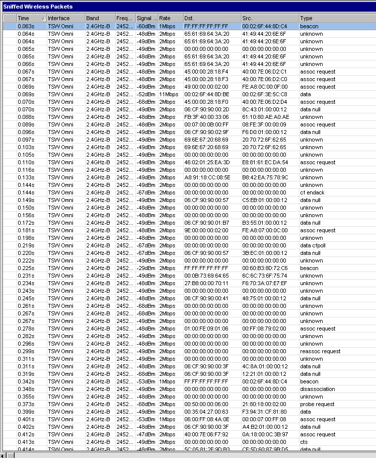

Can someone please help me determine what is going on with my wireless network. I have captured some of the traffic and cannot make heads or tails out of it, but something seems way wrong. I have attached a screen shot of what I see, and can post the raw dump I downloaded from MT.

From glancing at the screen shots it looks like you may be having the same problems as others are experiencing in this thread which can be solved by upgrading to the latest version and following the instructions provided in this thread.
Hope that helps.. If not please most more information like the AP logs, detailed symptoms you are experiencing, and more info about your AP and client config/hardware.

The problem appears off and on. Most of my customers use cb3’s. My clients always connect with good signals but occasionally they cannot pass any data at all (this problem only started last week, and we did not make any changes). At 28 byte pings sometimes can get a packet through but at about 80-90% loss. I reset the AP, etc. and nothing seems to work. I am using a 2511 as the AP already and 2.9.45. The only thing I have seen different on this omni as compared the sector on the same tower is that there is a huge number of unknown packets with very strange MAC addresses. When I was experiencing the problem I replaced the MT AP with a cb3 AP and still could not pass traffic. My only thought was that all of those unknown packets were some sort of attack. When things seem to be running fine those unknown packets do not show up in a dump.
