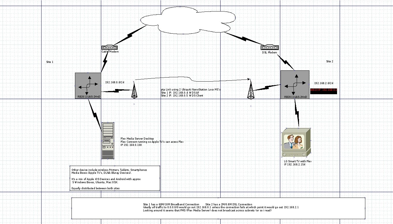

So me and a friend both bought some new RB units (Rb2011UAS-2HnD).
Previous to this we had Routers running DDWRt.
We had a pTp link running over 2 UBQ NanoSta Loco M5’s
The goal is to link the 2 RB’s with the pTp link and maintian our independent ISP connections on each side with failover implemented.
We do run plex on each side of the pTp link, so we want devices to be able to see and access that media.
Site 1
WAN (Cable Router) eth1
IP 192.168.0.0/24
pTp 192.168.0.4
PlexMedia 192.168.0.100
other devices (Apple TV, DLNA BluRay, iPad, printers etc)
Site 2
WAN (DSL) eth6
IP 192.168.2.0/24
ptp 192.168.0.5 (eth10 not in bridge of RB)
Plex 192.168.2.143
Currently separate subnets, but is that the best way to do this? VLANS?
It’s not important to see the AppleTV’s between sites so BonJour isn’t a great concern. Plex across the link is a must have though.
Besides the link we’ll want to implement cost based routing for the GW (the Cable Modem connection is approx 20 times faster) so devices in Site 2 should be using the ptp link to the RB for Internet Connectivity when possible
Thanks for any help.

Can you pls draw the requirement in a paint file? That’ll help us better understand the exact requirement. :slight_smile:
hope this helps
