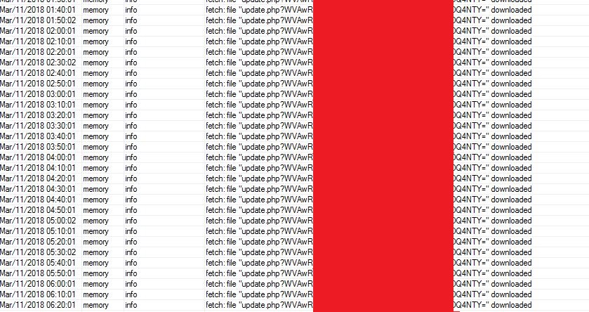

I have a script to check and possibly update my freedns account every 5 minutes.
I would like the value not to be logged memory info fetch:file “update… etc etc” .
I would not have this value in LOG, everything else… It’s possible?
Can anyone help me?
Thanks in advance, sorry for my bad english.

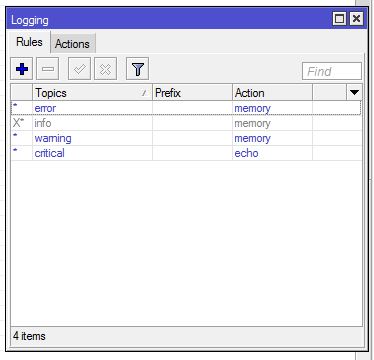

Maybe try adding “not script” i.e. !script to the default “info” topic under system logging
Thanks for replay and for the help.
I’ve disable ALL info memory logging, but in this case I’ve stop to logging ALL Info…
I don’t understand if is the correct way…
Thank you.
Example shows that fetch is logged under topic info. If you want to hide such messages, then you simply have to disable info topic. There is no other way.
Lets say, if we use as an example L2TP logs, then part of them is logged under info,l2tp topic. Then you can under logging rules change topic from info to info,!l2tp and then all info logs except l2tp ones will be saved.
