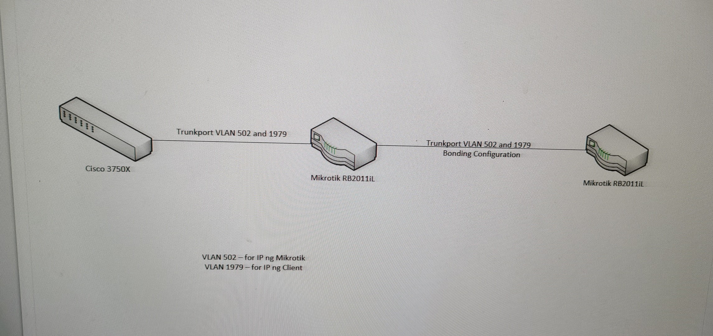

Any references on this setup. Cisco trunk port going to mikrotik trunk port going to mikrtok. Please help me. Thanks. My setup is on attached file
