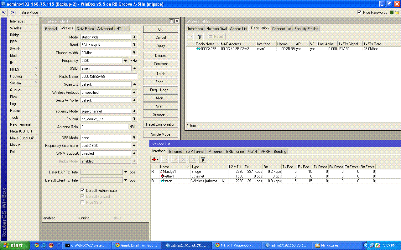

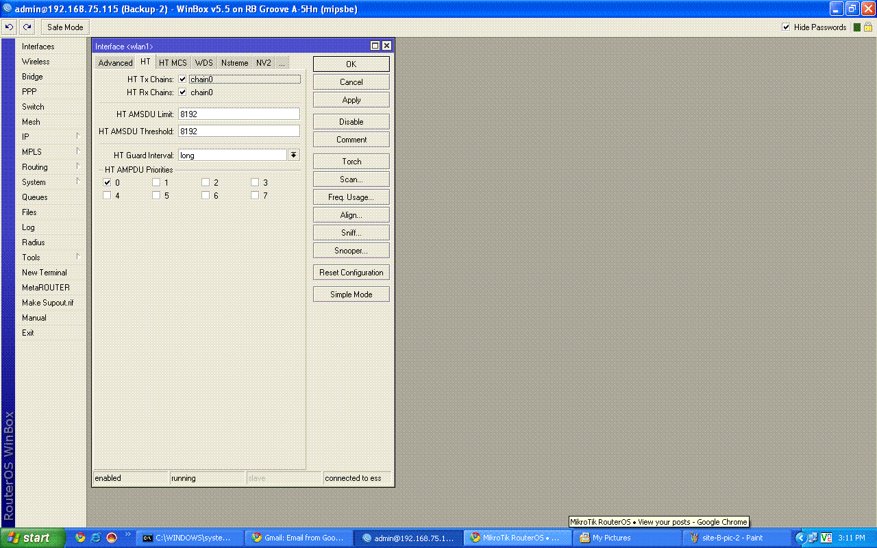

Please post your /interface wireless print and /interface wireless registration-table print stats from both routers.
CCQ = 70-90 sometimes above 90%

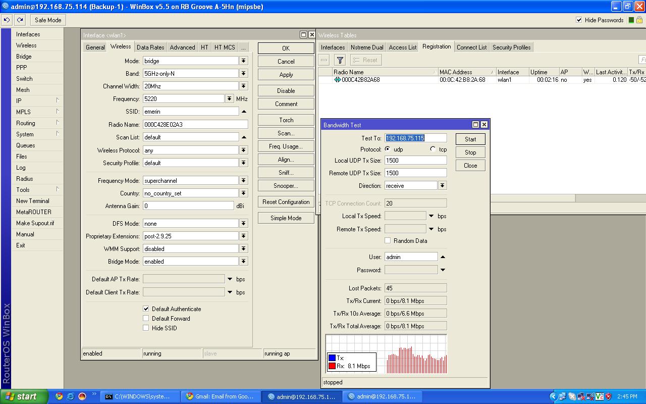

Data rates = default, tx power= default. WDS= dynamic
here are the pictures for Site -A
data rates = default wds mode = disable, tx-power = default

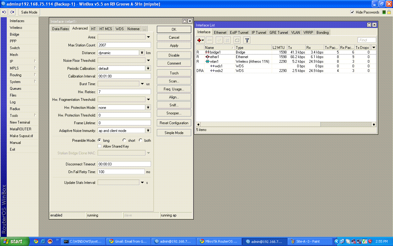

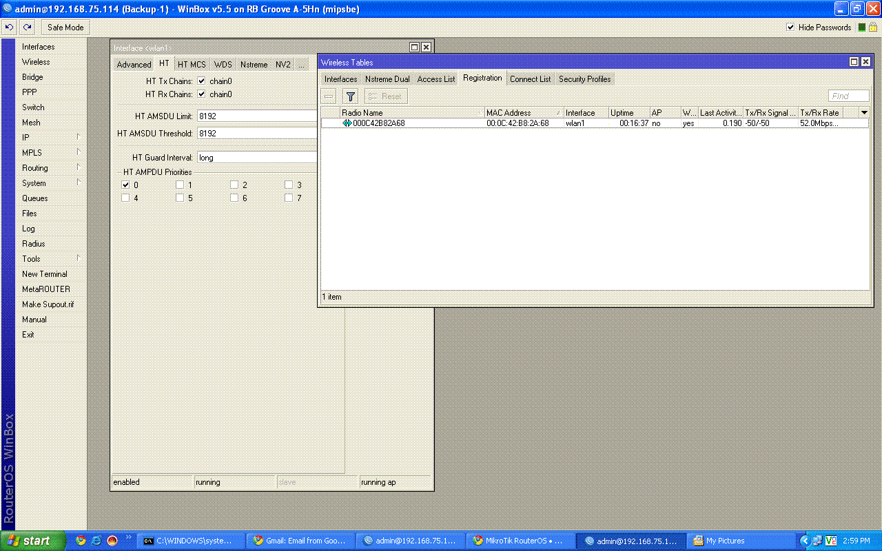

here are the pictures of site-B
you are running bandwidth test on the groove itself? this is the problem. bandwidth test generates a lot of random data, this impacts the CPU and you don’t get any speed. correct way to test is:
[powerful pc] → [grove] – [groove] —> [powerful pc]
i have done it too the results are the same, i already mention, the older running link is performing fantastically at same distance..with normal 5GHZ turbo. and in this older link when i run btest on the RB itself, then its easily push 36 Mbps in one direction with a problem.

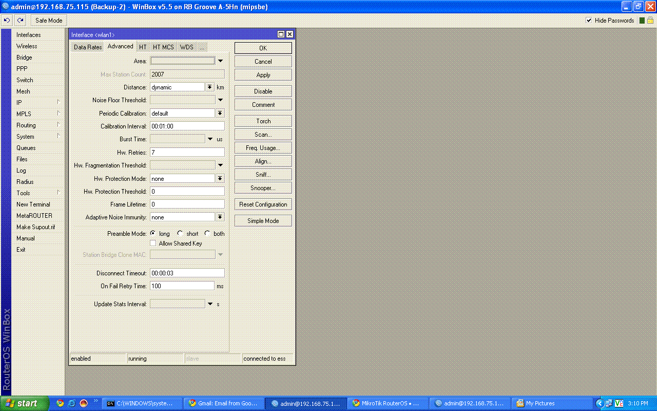

some more picture of Site-B

Try disabling adaptive noise-immunity on both ends.

i have already done all possible settings without any results. i have pour my 7 years experience into this link. enabling HT above/below downgrade the through put upto 3-4 Mbps. only in one direction. surprisingly when i configure these groove to traditional 5GHz 20 MHz then it give 14-15 Mbps in one direction and when i try to use NV2 or nstream on AP and leave the protocol mode to any in client side then the link wont connect even.

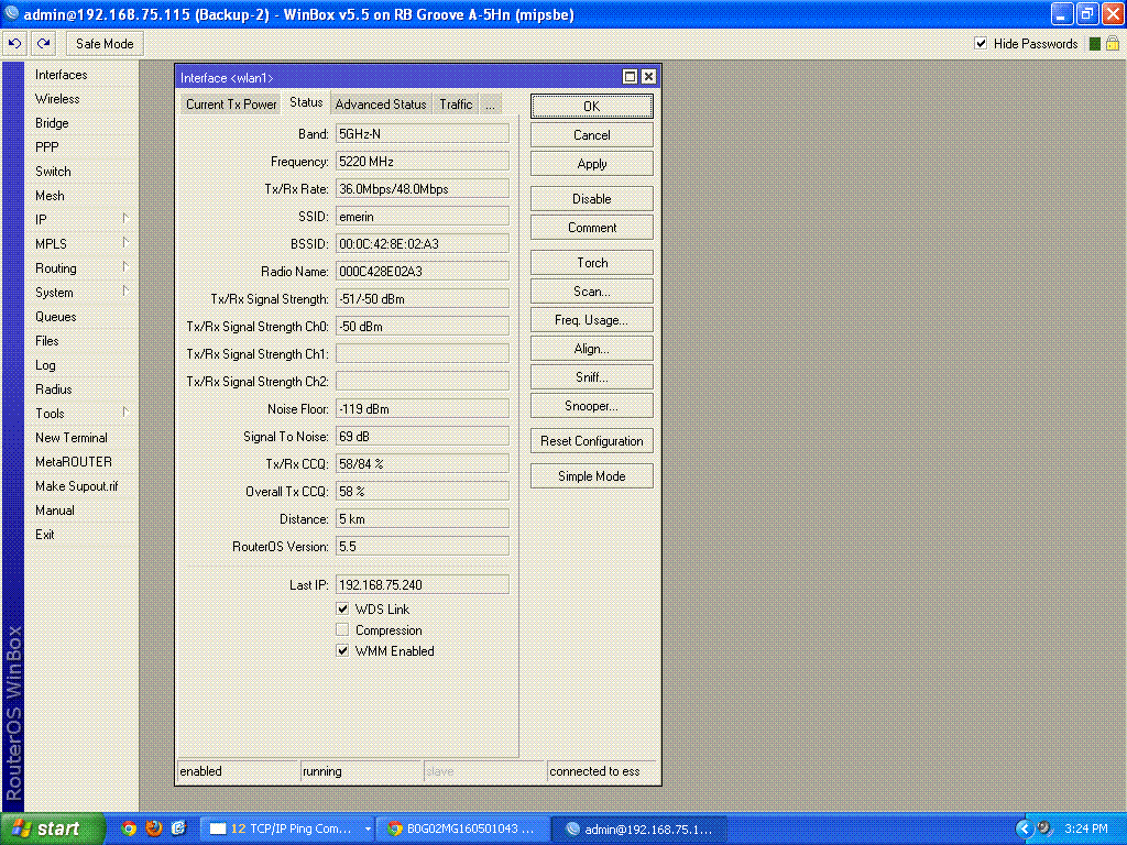

your signal is -50/-50, how can the link “not connect”?? either your nv2 settings were wrong, or some other reason. upgrade to v5.6 where we have more detailed logs, and make a supout.rif file when it doesn’t connect
i dont know why, its a mere 6 km link but it appears to be 60 km link. one more thing the link only connect only on frequencies which are marked as bold in drop down list of frequencies. if i try to connect on any other frequency then also link dont connect… this is first time i m seeing this.

bold means “in default scanlist”. to use frequencies not in bold, you need to write this frequency in the “scan list” setting of the client
Just noticed you have “no_country_set” and superchannel in frequency mode, have you tried selecting your country and manual tx power also wireless protocol is not specified
this is not a problem as long as the scan list setting is configured in the client.
yes, this is strange. try to set something there, on both ends. For example on client side “any” and on the AP side try out 802.11, then test with nstreme and also with nv2.
