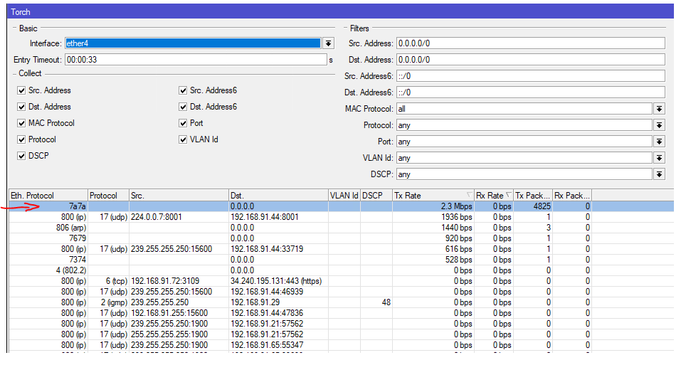

Hi does anyone have a reference for the Eth. Protocol codes in the torch tool?
I’m trying to figure out what the “7a7a” traffic is. Ether4 is part of a bridge with a single host attached to it (a sensor relay that should see almost no traffic). I assumed it was some kind of broadcast traffic but I’m struggling to identify it. I couldn’t see it at all with the torch tool until I disabled hardware offloading in the bridge port config for that port.
Thanks for any help.
One possibility is wikipedia article about ethertype. A more official one is IANA assignment table.
Neither list ethertype 0x7a7a … so some device uses some proprietary protocol on top of ethernet.
Thanks for the help.
For anyone else who comes across this, I don’t know for sure, but my primary suspect is SKY-Q boxes exchanging video streams.

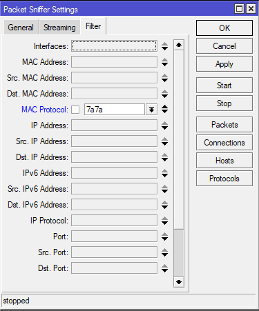

You can use sniffer to capture only 7a7a ethertype (The sniffer uses name “MAC protocol”)
See Mikro Tip MikroTik packet sniffer basics at offset 01:33
You should be able to capture only 7a7a with this setting:
Then you should be able to see what mac addresses are involved, and if you have managed switches, you could determine which port those mac addresses were connected through.

Why uselessly autoquote yourself?
Also on image 7679, 7374, and… 4?
Not intentional. I edited the post, phpbb won't allow me to delete it once there is a following post. (That's another difference between phpbb and other forum software I use).
Was that for me? Here is an example of when quoting makes sense, to provide context. I thought you were referring to the image I posted, but after puzzling over it, I went back to the original post and see that you were referring to the image in post #1
Really… when nothing specific is quoted,
each time it refers to the first post or to the immediately preceding post… :stuck_out_tongue:
Sorry, is not my intention confusing you…
