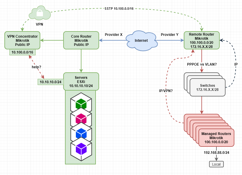

Hello! First post here, having trouble with my project. There is a diagram in the attachment for details.
2 small problems I have
Need my SSTP IP’s accessible from the local network (server) 10.100.0.0/16 to 10.10.10.0/24
Not sure if this is an ESXi networking issue, but the servers are getting a 10.10.10.X IP and not able to ping 10.100.1.4 for example.
__
Need access to the Switch and Managed Routers via IP that is tied from the Remote Router over the SSTP VPN, not traffic but access only.
172.16.0.0/28 and 100.100.0.0/20
__
NOTE: In the config is the 10.102.0.0/16 IP range not 10.100.0.0/16 in the diagram (will move it over after its working)
Know I can put SSTP on each Manged router then it doesn’t matter on the IP, but then I have a ton of SSTP end points. Tried proxy-arp on the core and vpn, didn’t make a change.

Did you add the appropriate routes for those networks ?
