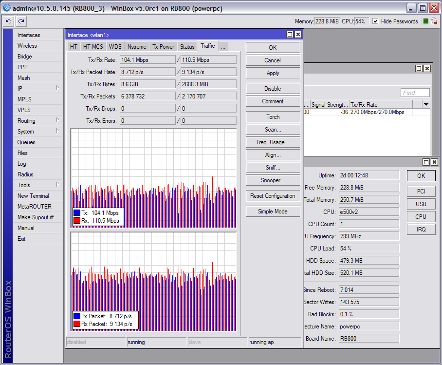

Signal strength -36 LOLOL

What hardware setup are you using to get that results?
Is it possible to get those results with RB433 cards at each site?
My rb450g topped out at 200mbits tcp performance over gig-e.
I would imagine you would want to use at least an rb433AH to get 100mbit full duplex over wireless. the 433vanilla is probably too slow.
derr12, don’t run the test from the RB itself, run it from powerful x86 routers at each side of the RB. This way the TCP termination would be handled by the x86 (or more powerful RB) and the test subject will be tested for routing and forwarding performance. In case of Layer 2 bridge - the throughput should be even more.
