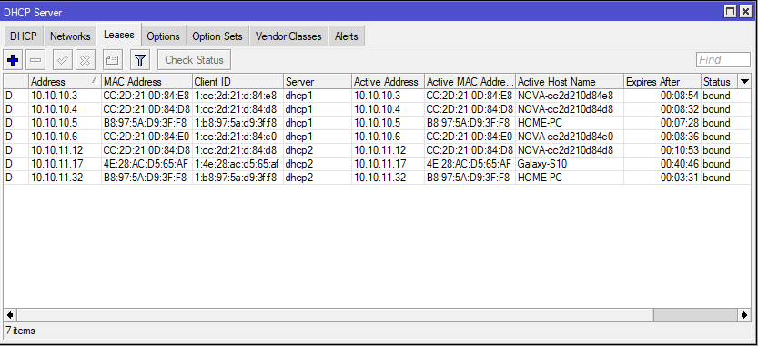

please look at my DHCP Server - Leases,
I couldn’t understand, how can my HOME-PC get DHCP leases from both DHCP ?
And also my Nova access point, can also get leases from both DHCP…
What mistake did I made?
You are floundering and need a plan.
Start from scratch
Leave the default firewall rule settings in place that come from the factory.
Slowly add back in your requirements changes and networks.
The one WAN rule with masquerade should all you need for sourcenat rules
For DNS servers temporarily use 9.9.9.9 and not the one you have used in the settings from before.
Then repost config and we will go from there.
Starting clean with a proper config will make things go smoother in the long run and much easier for us to discern the exact problem area(s).

In any case none of your configs were setup to use the ISP dns so why you state the question was surprising.
For understanding purposes.
Groups of users include
a. two spouses - unlimited
b. kids - limited
c. guests - limited
However you are willing to put up with all being on the same subnet and all having to login via hotspot.
Wifi - is not vlan aware or capable and thus you really have no options.
Your wifi totally dictates what you can do.
So in summary, any issues are probably with your hotspot setup and thats what you need to focus on!
THis seems like a decent starting point.
https://www.youtube.com/watch?v=QlCC5b7dSlI
I guess one creates a separate network for the hotspot within the hotspot setup and no where else?
In your firewall rules you may need to add
add chain=forward action=accept in-interface=HotspotBridge out-interface-list=LAN
Ended up, setting all the interfaces in my router (the bridge) to hotspot mode.
For devices and PCs that I wanted to bypass login, I had to manually IP bind them, and set as bypass.
Temporarily, this is a solution that works for my case. No more internet drops.
Not a sophisticated technique though, as every new wired has to be pre-input to be able to access the internet.
yes your config is probably not optimal
I will try to find some time reading up on hotspot so that we can get you to a useful efficient config!!
thank you! and please let me know how can I achieve my goals without using current config which I have to bypass all my private devices manually.
