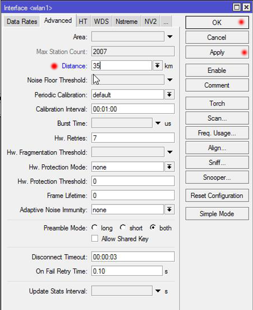

Set ack-timing on 35 Km
Go to “wireless” click on “advanced” and by “advanced” kan you change distance dynamic to 35
Try this

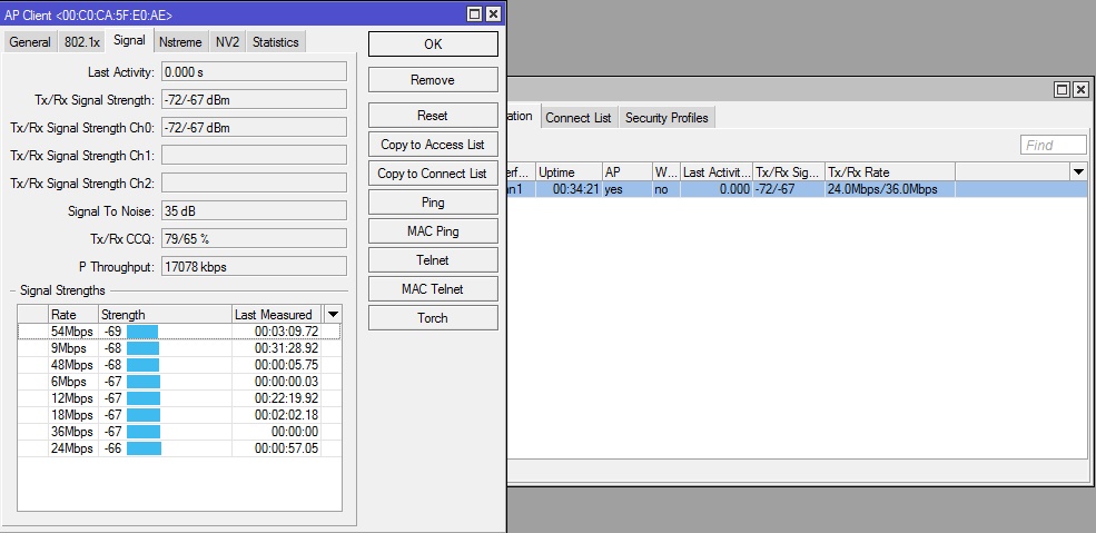

The signal strenghts are both side -83-85 dBm?The freshnel zone is clear?And what about the latency, packet loss,speed…etc, i am a beginner in the wireless networks, but i think you should need this settings:

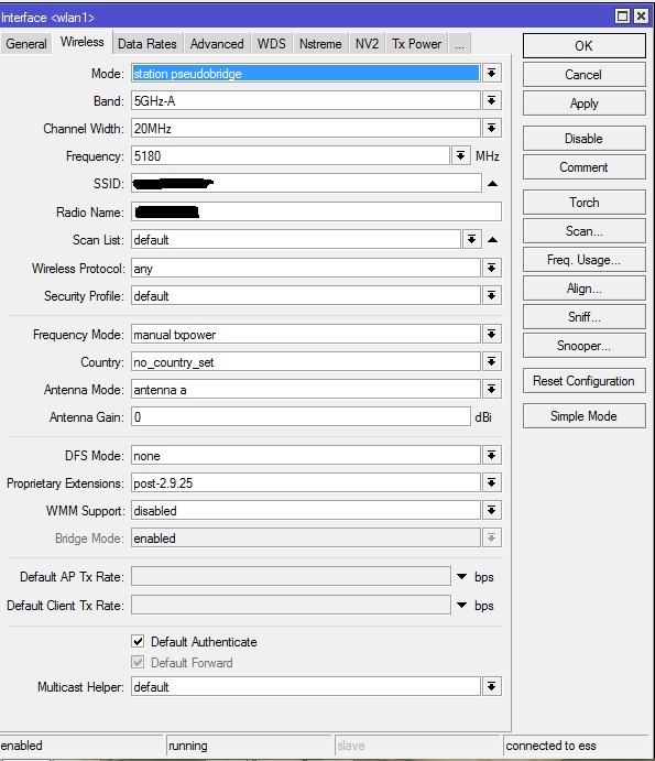

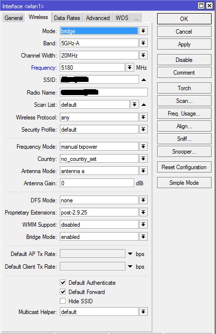

My RB433AH Router board did not show me the option
Wireless Band - 5GHz-only-N
I have only one option “5GHz-A”
I Use your settings with “5GHz-A” option but the signal level is higher than current level, throughput seems ok
and when the load goes through, the throughput is lower than the above settings.
is it ok to use “5GHz-A” insted of “5GHz-only-N” ?
thanks for your settings
but it did not work for me. Thanks

Have you setup ack-timing (by advanced settings "distance) set these on 34 Km normally stand this to dynamic
If I put ACK timing 34/35 Km insted of Dynamic
After sometime the throughput freezes, and removal from reg. table will solve, and again connected for few hours.
signal stable. but throughput freezes several time
