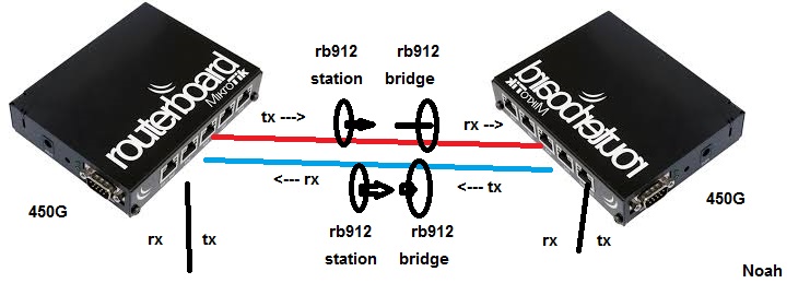

Yes brother, I think we have reached a solution 450G Router
In ether 1 full duplex TX and rx
In ether 2 tx
In ether 3 rx
On the opposite side of the same process
Router also 450g
How will the settings in this case
I am grateful to you that you try this wonderful has shown me some things, but I hope to be a right way and controlled

Brothers, who can help me in a way to prepare the existing connection in the picture above
